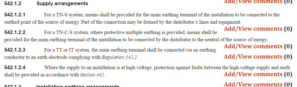

Also achieving the values required for touch voltage are likely not to be met,
Very likely, given that electrodes are currently seldom used, there will be plenty of electricians/installers who have never encountered one, and in many cases shoving a 3ft piece of metal in the ground is totally inadequate.
I did that and it let me in but every time I clocked one of the headings it didn't let me in. If I opened in a new tab I got the same page.
To be honest the only adequate thing possible would be a metallic connection directly to the substation earning terminal. The resistance of the actual earth is high enough that your return path to the substation and any (still) bonded metalwork that's also earthed in the area is not going to help much.
But a metallic connection back to the substation is basically given in a tn system and that's what they're worried about losing.
It would all make sense if they said it was just to trip the RCD rather than reducing touch voltages.

I can't see 542.1.201 getting off the ground (scuse the pun...), at least not in its current format.
Regulations are NOT retrospective, so no need to fit one or 25,000,000.
Except where 132.16 is concerned. That was EFLI's point, or have I misunderstood?
