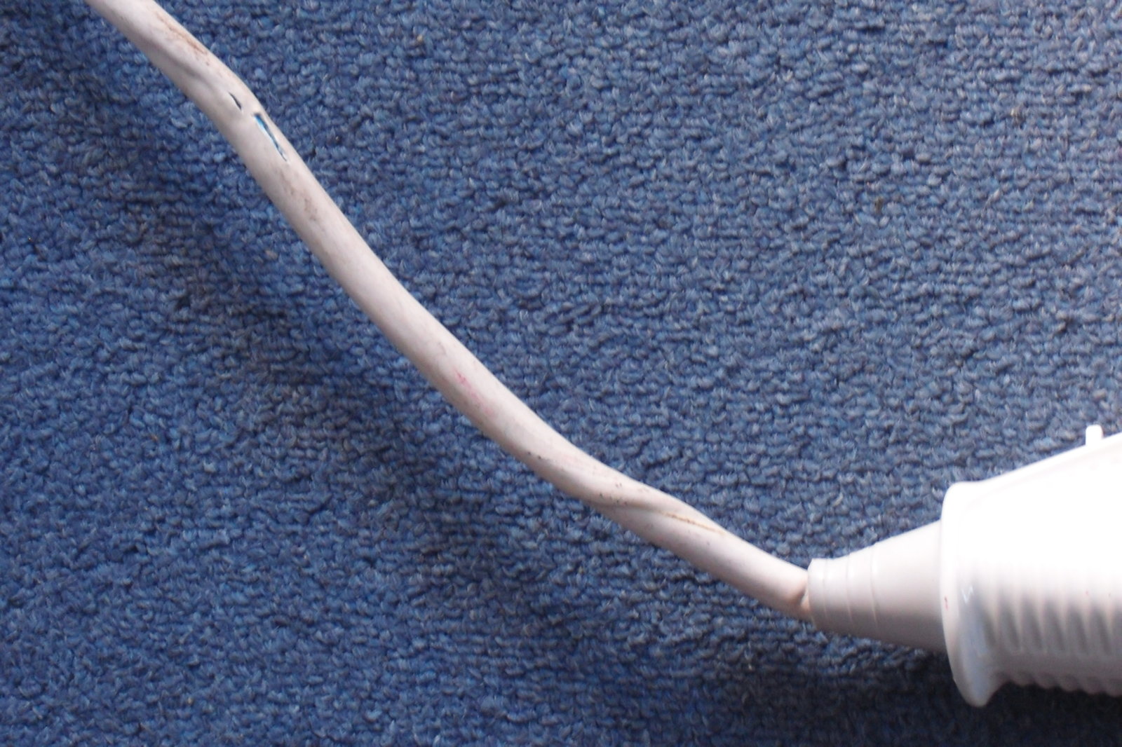

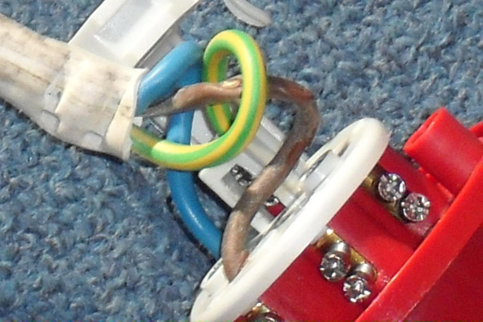

Indeed, the only situation I would expect to find unprotected cable is directly off a bussbar where it is terminated with some sort of OCD. I have encountered far too many overheated cables to want to introduce any unnecessary risk, example I refused to supply temp power for a food trailer using this cable.
and this panel which 'stopped working' on Christmas day a few years ago.
