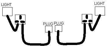

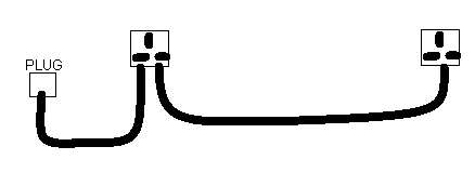

3 pin plug to socket
How are the lights controlled? Switches on the light?
I'll probably get shouted down for this but if the lights have permanent power running to them, can you not use that for the sockets too?
When you say no need for a junction box, do you mean I can wire them into the same plug? The idea of the junction box was to split the flex from the single plug out and then have one cable to each side of the bed with a socket for each. The socket I want to use to feed these is in the middle of the bed behind the headboard with one currently feeding a light on each side in the exact same configuration as I want for the sockets.
Wouldn't it be better to use 1.25mm cable fused at 13A?
It strikes me that it'll only be a mater of time before someone uses one of these sockets for a hairdryer.
