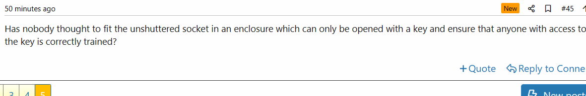

Has nobody thought to fit the unshuttered socket in an enclosure which can only be opened with a key and ensure that anyone with access to the key is correctly trained?​
I've already said that in terms of electrical common sense, an interlocked unshuttered socket would seem to satisfy the spirtit of BS 7671's requirement for shuttered sockets, so we're only talking about people who feel the need for strict compliance with the every word of BS7671.
For those concerned with 'the every word of BS 7671', I imagine there would be some debate as to whether or not the above suggested 'workaround' would be compliant. BS 7671 says that every socket must be of the shuttered type if it is "for household and similar use", but without defining what that means, and without suggesting that use by a 'correctly trained person', within a domestic environment, would not be regarded as "domestic and similar use".
In general, something which is disallowed by regs (because it is potentially 'dangerous') does not automatically become acceptable if it is only accessible by a 'correctly trained person'.
There would also be the question of how one would ensure that the only user(s) was/were 'correctly trained', and how one could ensure that only a 'correctly trained' person could have access to the key.
However, as above, common sense is not necessarily the same as strict compliance with every word of the regs.
Kind Regards, John
