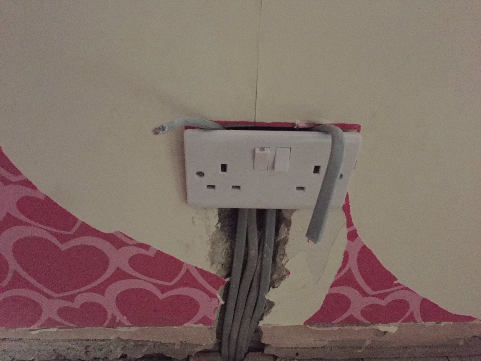

I’m building a walk-in-wardrobe in my daughter’s bedroom and at the moment there is a double socket where the wardrobe will go, and will probably become pointless.
I was thinking of moving the socket so it could still be used or even just removing it and putting a junction box under the floorboards.
The problem is that I have found that there are 4 cables going into it.
We had an extension done a couple of years ago and I’m assuming that the electrician used this socket to loop the new sockets in the extension to and from. Ie a ring off a ring, if that makes sense?
I can’t understand why he would’ve done that though, rather than removing one cable out and connecting it to one of the new sockets then continuing the ring of new sockets then back to the original said socket?
Is there any reason why he would do that? Maybe the new complete ring would’ve been too long? Or is it just laziness n bad practice?
Anyway, am I best to just leave it as it is and not worry about it? Or should I do what I thought he should’ve done in the first place by reconfiguring the circuit?

He might have done but it is not the ideal way to do it although not inherantly dangerous, it makes testing difficult.
Much more likely is that the two extra cables just go to one socket each. Are there any nearby which have only one cable?

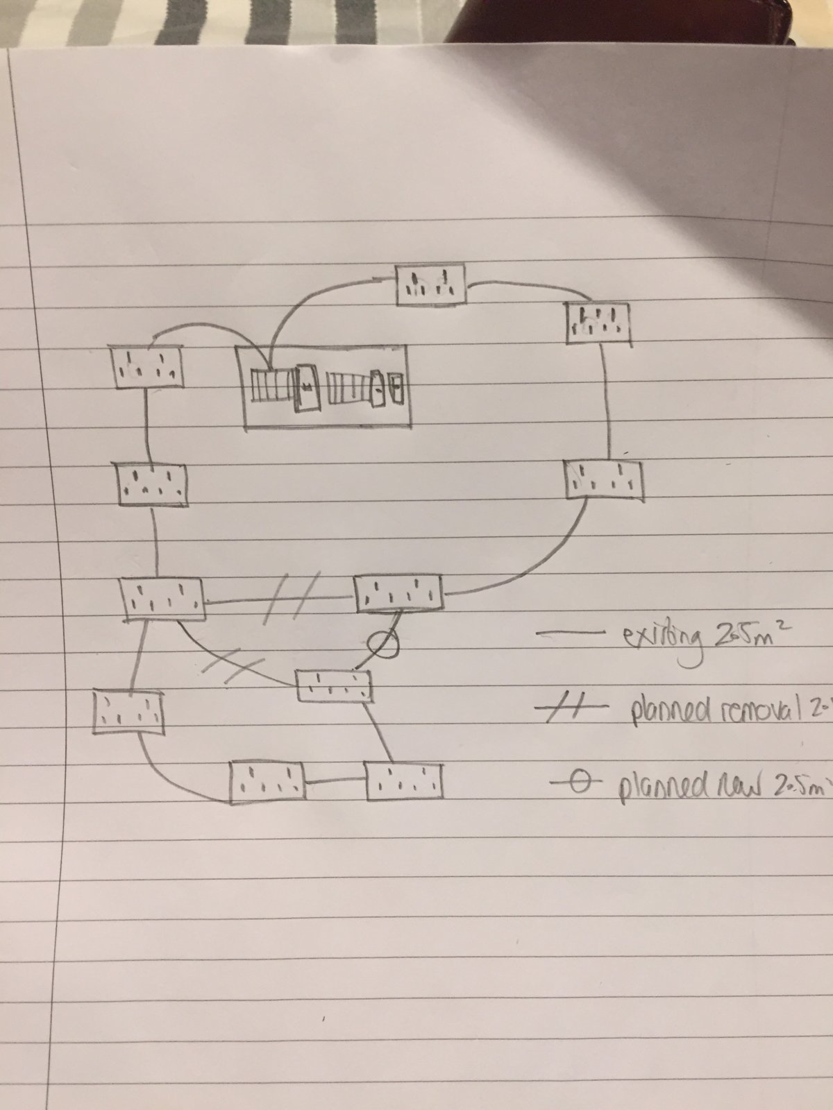

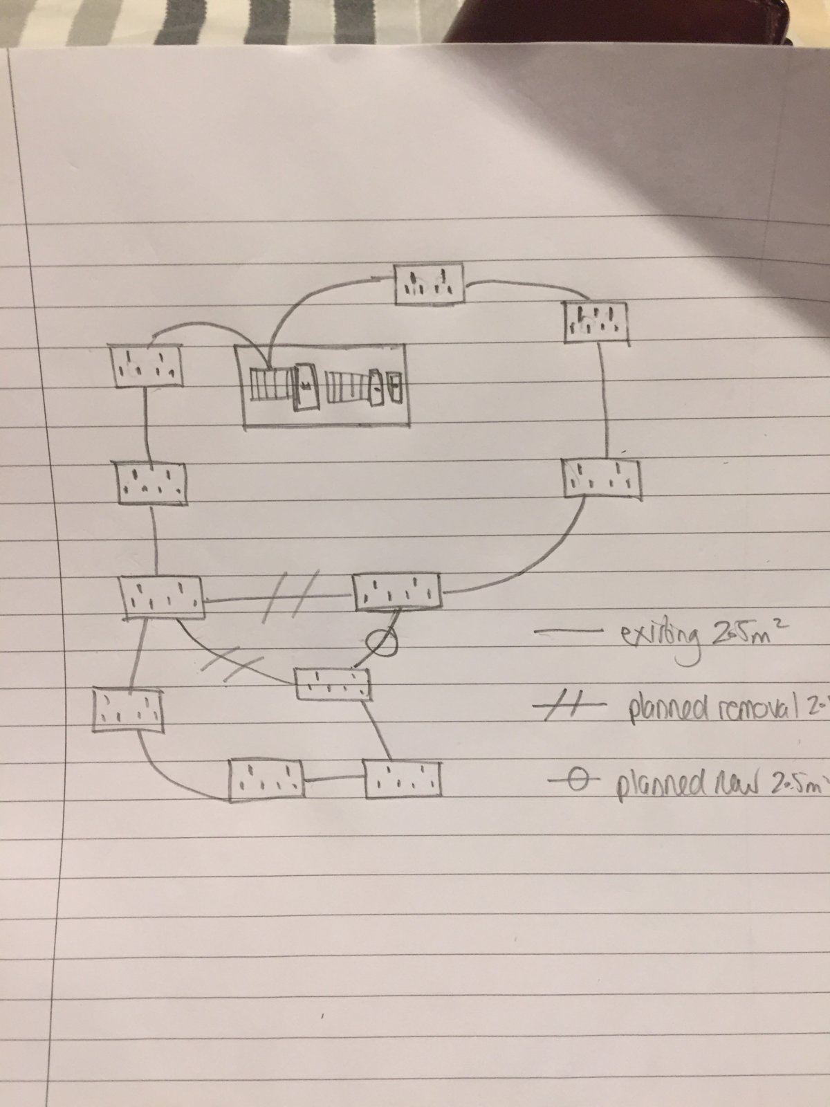

Is it worth altering? I can fairly easily remove one of the original cables and take it straight to the 1st new socket and therefore remove the cable that goes from this socket to the original socket, leaving a complete ring circuit.
What are the pros and cons in altering it or leaving it?
No, do not alter.
If it is a ring on a ring (figure of 8 ) then both need to be connected, otherwise you will have one spur with only one 2.5mm² on a 32A MCB with an unknown number of sockets.
Yes, but they will all still be connected in a ring because all the new sockets will still all be connected in turn back to the old socket which I’m talking about.
Excuse the crude diagram! Hope this explains what I mean!
Obviously the number of sockets isn’t accurate!

I am disappointed. I thought you said it was a crude diagram?
:sneaky:
Yes, but you are not certain that is what has been done.
Either you’re super impressed with my diagram, or you were expecting something completely different!

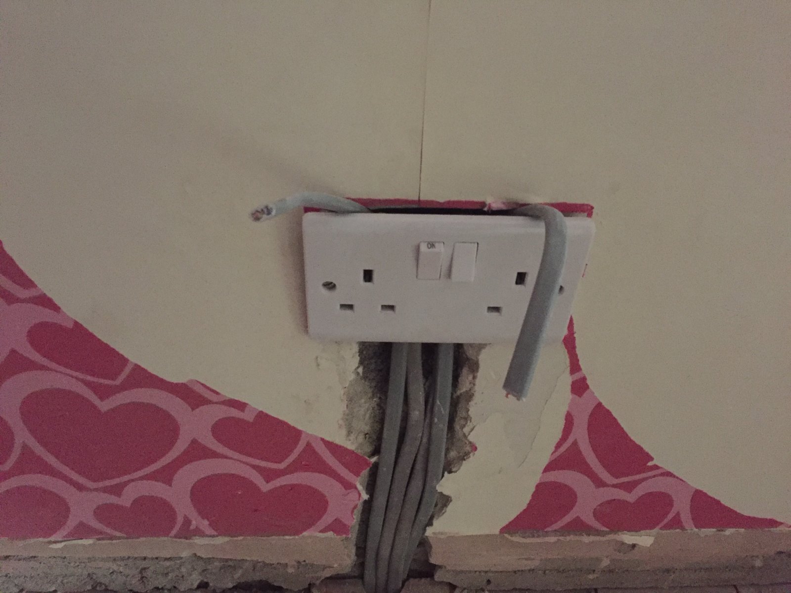

Here’s a photo of the socket when all the original sockets were working and the new ones were all connected up together but not actually connected up to the mains.
I had expected you to leave all four cables at the socket, and do joints with connector blocks, but your diagram does look a 'tidier' way of doing it.
Assuming your diagram is correct, then all looks ok to me.
I would personally correct the ring final circuit, so it is a traditional ring, but would only advise this if it can be proven to be safe and compliant and all testing is carried out by a competent/skilled person.
