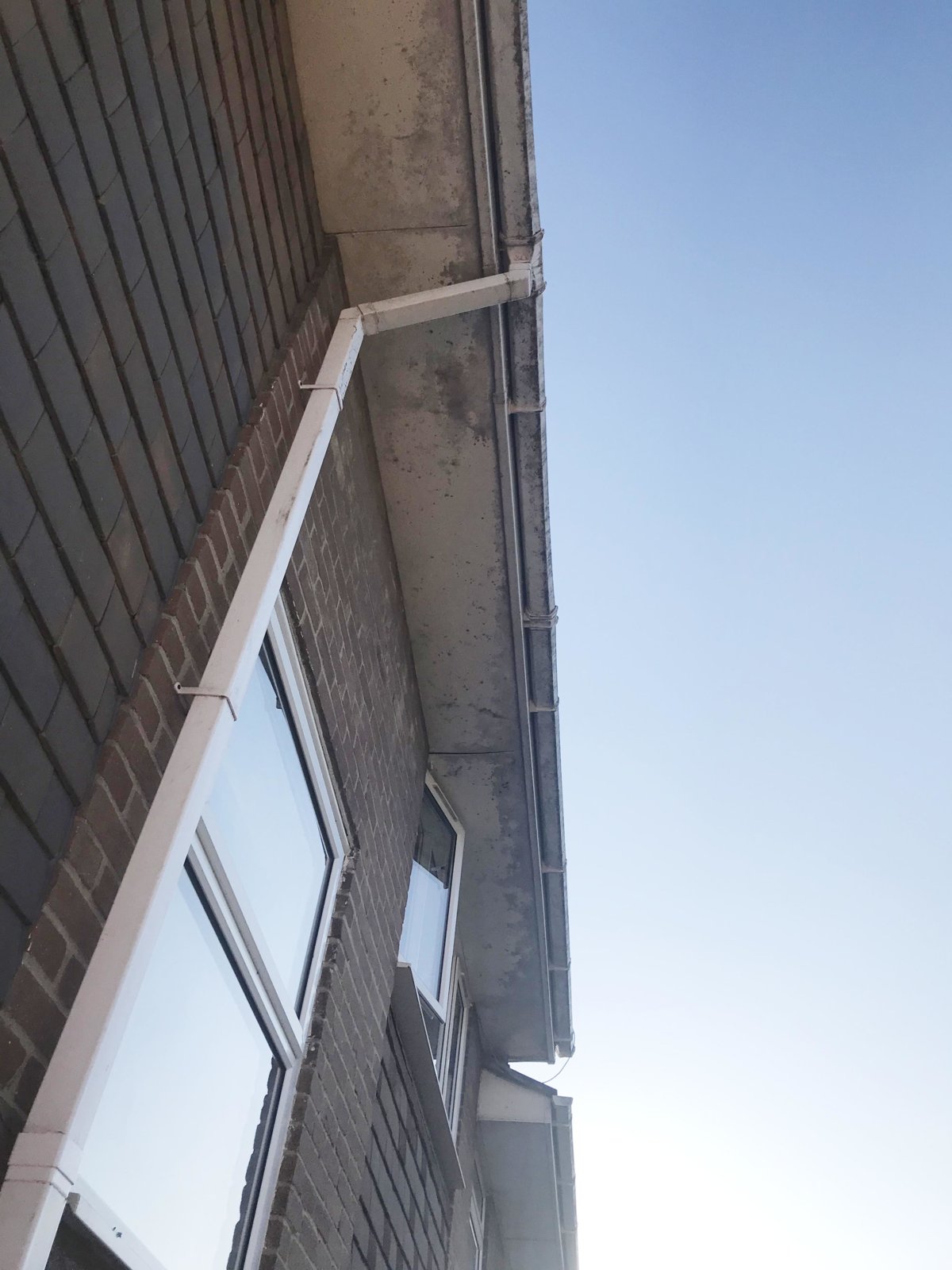

Hi,
I'm looking to replace my soffit boards.
They are 600mm wide! The vented soffit board is expensive at £100 for 5m (need 3 lots). Will probably cut them into 2.5m sections and fit with H bars.
Is there another way of doing them? Some neighbours have the interlocking boards laying the other way but it doesn't look great. Would they be glued together with mastic?
Any other options?

Use hollow soffit and J-trim and go in the opposite direction to the fascia. Looks a gazillion times better too. It's quite difficult to try and fix long lengths of floppy sheet without 7 pairs of hands, especially if you are guiding it into a recipient trim.

Thanks Noseall - good point about the length of the boards. I would have had them cut to 2.5m each to fit in the car but its still a long bit of wobbly board to fit!
I did wonder if they were asbestos! How will you drill the holes for the vents without disturbing them? Most of mine are not nailed - just sat there!
Im hoping to have an extension built across the back so looking for a long term solution. Would painted wood last a long time?

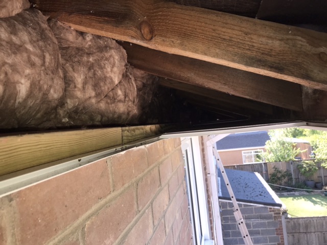

No. They need to slot into a J trim against the wall and are normally wrapped by a fascia toe (when overlaying the fascias with cap). You may be able to J trim both ends of the soffit pieces as the seem long enough to flex into place. You then fix self drilling screws (same screw you fix the J trim with) through the dedicated fixing lip on the hollow soffit.

the boards are just sat there. One end on the top of the bricks. The other rests on the lip on the facia board. I guess if I slot the hollow plastic underneath it wont go anywhere!

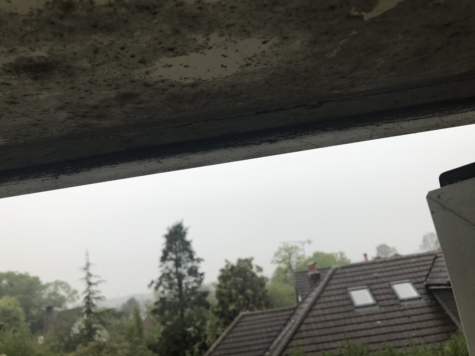

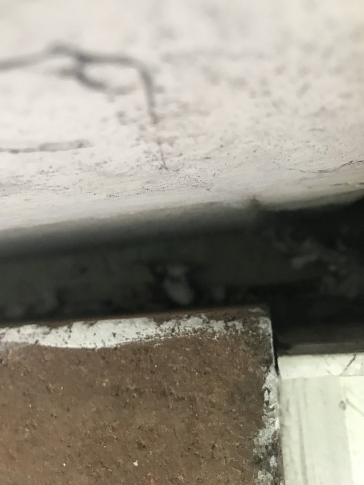

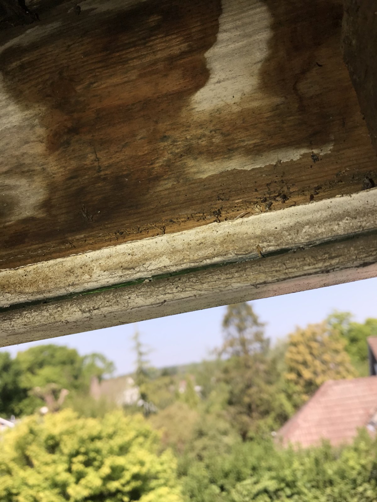

Just hung out the window and took some pics. The boards are not fixed house side and rest on the bricks / top of the windows. They are somehow fixed at the facia board. Will investigate further once the weather cheers up and get the scaffold tower back out!

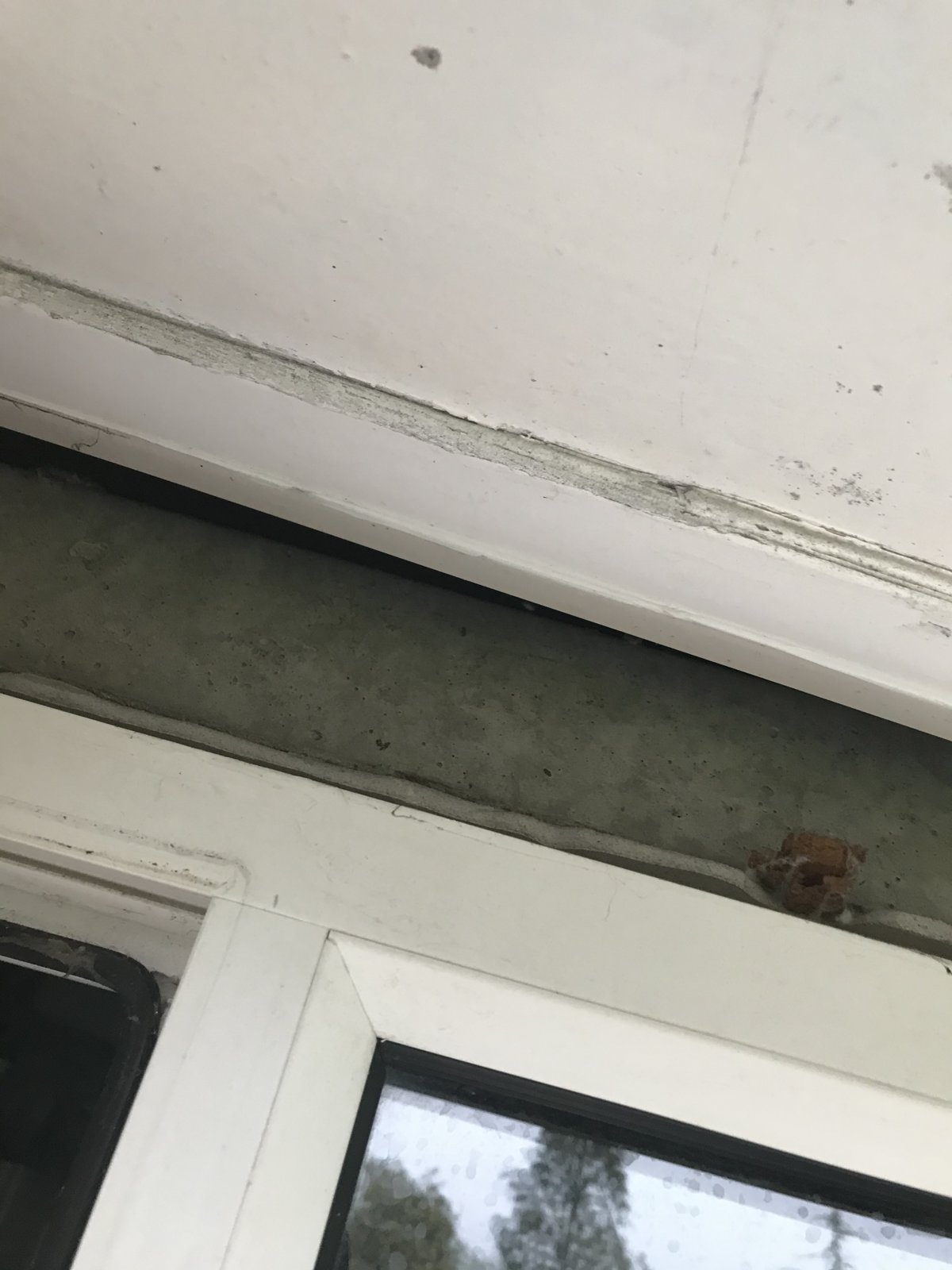

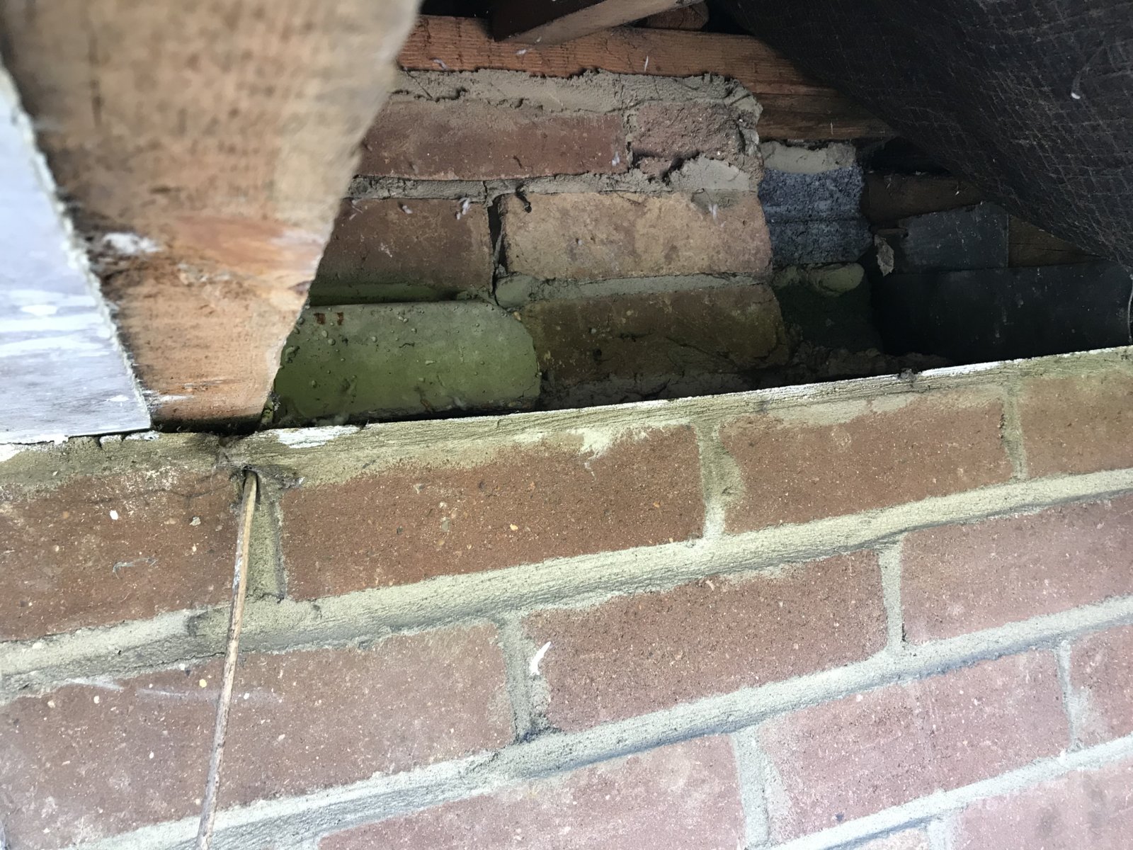

Any thoughts on fitting new soffit boards to this? The current soffit slots into the facia board via a groove and then sits on the top of the bricks!

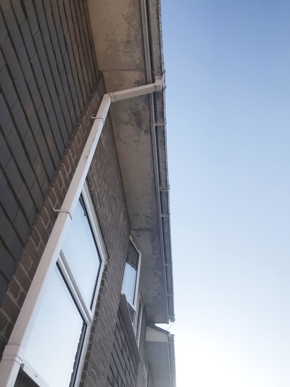

This is how I did it in the end...
