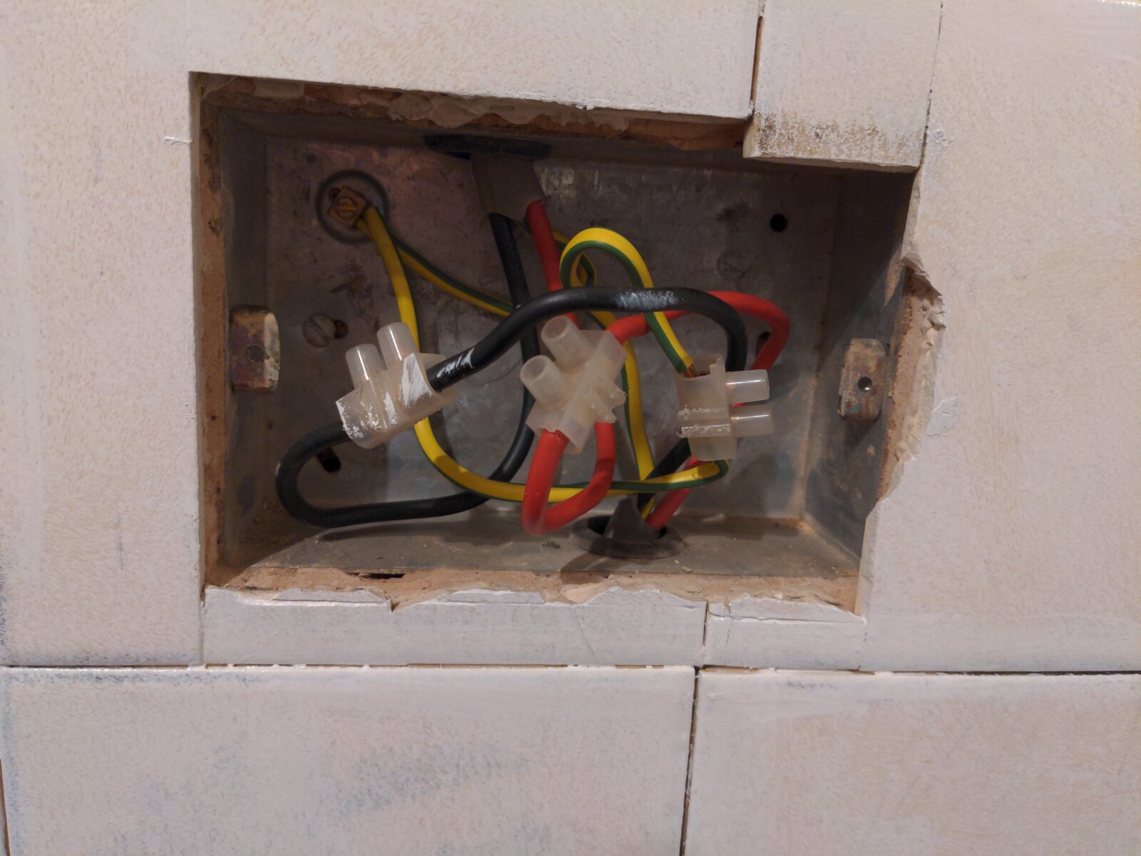

6x4" Blanking Plate
17 Nov 2020
3
The previous owner was using a biscuit tin lid to cover this!
Does anyone know where I could get a proper blanking plate for it? I can seem to find any back boxes which are 6x4 so, not sure what it was previously used for!!

There are no blank plates for that.
Where is the cooker switch now?
Looks like it down the side of the cooker. Based on the best before date of the biscuit tin, it's been this way for 18 years!
The cooker is entirely gas, and not electric.
It's hard to be sure of exact measurements, but if the spacing between the fixing lugs is that of a double socket, an MK5041 cooker panel may fit the hole exactly, available on E-Bay.
