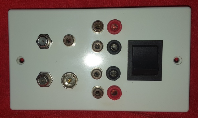

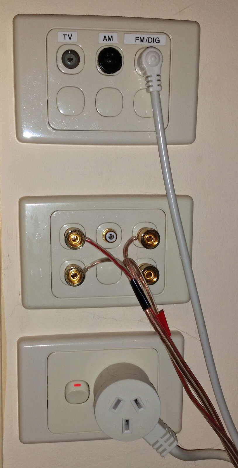

You can obtain "Gang Plates" with no mechanisms/modules installed. You can also obtain "Blank Modules" such as "G3544 Blank module" to suit these "Plates" https://www.detaelectrical.co.uk/images/Deta_Trade_2018-2019/Gridswitch_.pdf
(MK GRID PLUS BLANK INSERT WHITE (95474) are also available https://www.screwfix.com/p/mk-grid-plus-blank-insert-white/95474 and there may be others from other manufactures.)
One can then drill the Blank Modules and install any extra-low voltage connector which will fit in the space available - by either screwing on or securing with epoxy resin.
Thus you can manufacture "Audio" and other Extra-Low Voltage "Custom Modules" to suit yourself and insert them into the plate, as required.

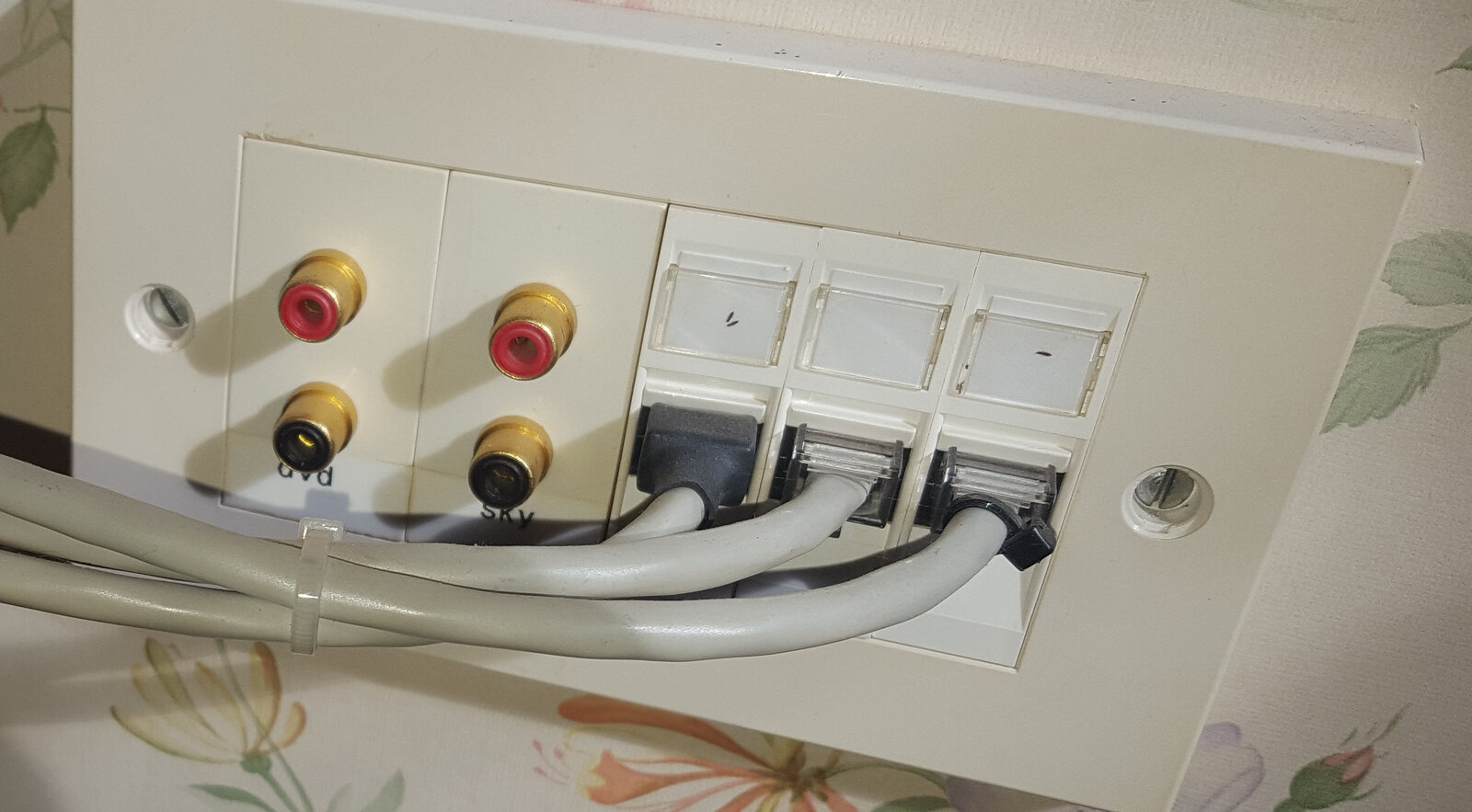

The photo shows some such "Custom Modules" installed in Australian Gang Wall-Plates.

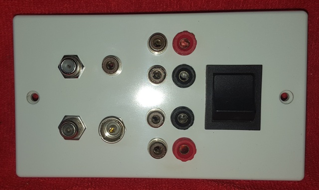

20210413_162242.jpg in the past I have drilled blank plates for custom connector layouts. but recently I have used euro module blank plates to do the same. these I did years ago
if you use full size blank plates dont fit connectors too near the edge as the back box is smaller!! and for anyone else who might like to try and do the same, contactum blank plates have a perfectly flat inside face

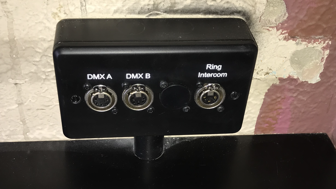

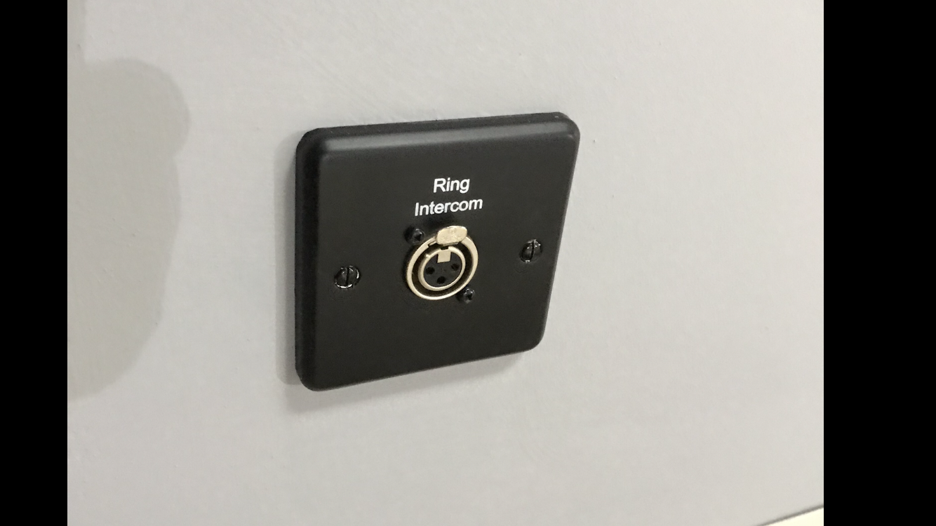

The plan is to punch D sized holes in the blank plate so a modular frame isn’t really suitable.
I can make a flat plate blank out of steel if needs be but if there’s an off the shelf product it saves some messing about.

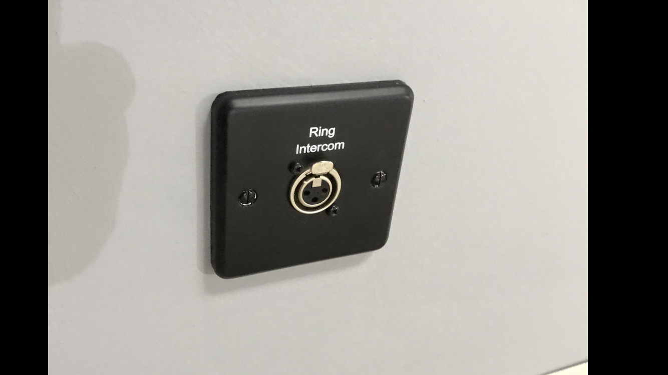

A5FECD47-DAE7-4470-971B-19E5ABF2B08A.png E6FF087D-92DB-40C7-B9EA-78BC0AA59D5D.png
These are standard MK blank plates which I have punched holes in and then painted and had engraved and I’m hoping to achieve something similar with this larger box.
