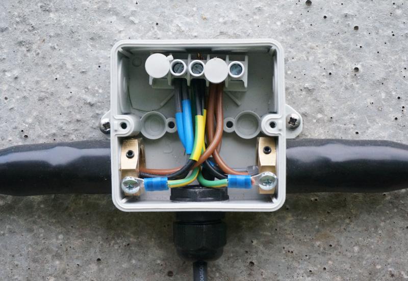

Thanks for the comments. Whilst at Alton towers a couple of weeks ago, I noticed that all of the plastic enclosures on rides had banjos on the outside. Some where mounted on rails, which would be subject to vibration... I guess this is just the way it is. I suppose if there is an earth core too, then only one of the ends would need to be in good contact for the armour to be earthed.

As I said, despite the theoretical considerations, I'm personally not convinced that tightening the banjo against a hard plastic box is really a problem. People happily do it with aluminium boxes (e.g. see this forum's wiki on SWA glands), and I'm not convinced that a soft metal, like aluminium, represents any less of a 'problem' than does a hard plastic. I'm certainly sure that it's a fairly common practice, even in my limited experience of such things.

im not a fan of using the armour as a CPC, regardless of whether it not it satisfies the andiabatic equation or not. Obviously I'll connect the armour to the cpc, but where possible, but I'll use cable with a core for the cpc
Same here. In fact, I've very rarely used armour as the only CPC. However, I suppose that even if one is only using the armour as armour, one still wants the connection between it and the CPC to be good and reliable.

It isn't hard plastic as seen in the pic on the OP, it is soft plastic! If it was hard plastic then it would probably shatter when tightening to it or drilling.
Aluminium is fine.

It isn't hard plastic as seen in the pic on the OP, it is soft plastic! If it was hard plastic then it would probably shatter when tightening to it or drilling. Aluminium is fine.
I reckon that's quibbling - I wasn't talking about brittle plastic. Aluminium is easy to squash.
As I've said, although I do use a pair of backnuts if I have them to hand, FWIW, I've never seen a problem due to tightening onto a plastic box - whether one calls the plastic soft or hard.

Here's what I'm both happy with and going with for the future. I would rather do a as close to faultless job as I can, if anybody ever looks at it in the future.
I've used stainless screws on the tabs and tightened them just so the enclosure has a fraction of movement against the wall, to prevent distorting the enclosure (and seal!) in case the surface isn't level. I'm going to put a smear of non-petroleum based grease around the enclosure seal and glands once its all tightened up as an additional seal. Comments?
Personally I would link across the glands for continuity, but not connect them to the CPC at the joint.
Also I would drill a 4mm drain hole in the bottom of the back of the box, so if any water or condensation does get in to the box, it can get back out again.
Apart from that though, looks like you've done a really good job of it. Well done. :)

I have come across a number of loose joins where metal vs soft plastic so it isn't a quibble, not come across a problem ally one yet.
I don't see an issue with cross bonding at an intermediate joint with bog standard mains stuff, with signal cables it could be an issue tho. Wether it is or isn't doesn't really matter in the above case, but is looking good, better than some professional jobs!!
Fair enough - you've undoubtedly seen a lot more than I have. Maybe I've just been lucky in what I've seen!
