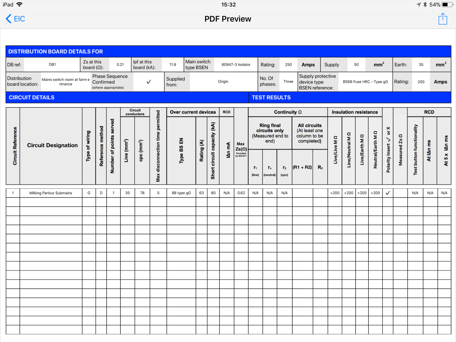

The small amount of thread inside an insulated enclosure is a good place for testing things like R1+R2 and Zs, as even if you aren’t using the earth for the downstream circuits, you stilll need to prove and periodically verify the armouring is correctly earthed.
Interesting. I confess that it would not even have occurred to me to do such tests when the armour was not being 'used for anything' at the downstream end. Do you think many people actually do that?
Would you do the same for, say, earthed metal conduit which was not being used as a CPC?
Kind Regards, John
Imagine you were filling in the EIC for this installation. What’s missing here...
Interesting question - a couple more "N/A" entries, perhaps? ...
... what would you say if it were a 2-core cable which was 'mechanically protected' (but not by earthed metal) [seemingly compliant with 522.6.204(iv) ], given that there would then be no "R2" (and hence no R1+R2) to measure ? The only option would then seem to be "N/A", wouldn't it?
Kind Regards, John
