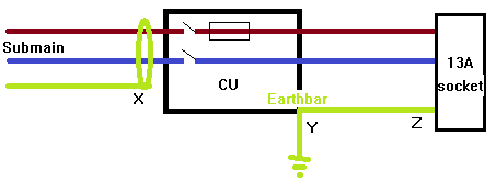

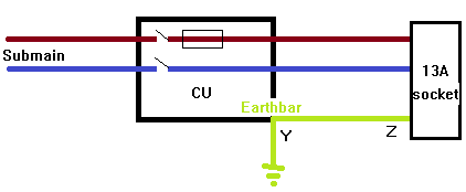

Are you not getting a bit confused here?
Surely the CPC mentioned in that has to be the relevant CPC for the circuit in question.
My understanding of that reg is the CPC that would end up at say a socket or other outlet point. is the point to test.
In this example of a TT system fed by 2 wires on overhead poles the circuit terminating at the 13A socket will I assume refer to the point 'Z' as the CPC.
Likewise at the CU the earth bar or point Y.
So on that basis why would you test to point 'X' when it is not relevant to the installation.
Or am I missing something fundamental?
A submain is a separate circuit, and requires a CPC and testing just like any other.
It would be tested using X as the CPC and recorded on the certificate as one circuit.
The other circuit(s) from the consumer unit would be tested using Y as the CPC, and they would be recorded on the certificate as separate circuit(s).
TT supplies on overhead poles are DNO items and not covered by BS7671, and they are not submains either.

However, I suspect that flameport's argument might be that whatever it is that receives the SWA (the 'CU' in your diagrams) is as much a part of the distribution circuit feeding it as it is of the 'local installation' - and that, as such, it is a 'point or accessory' of the distribution circuit as well as being connected to the local installation, and therefore that the regs can be interpreted as requiring the (appropriate, TN-C-S) earth to be 'run to' that place.
However, I'm far from convinced by that argument and, in any event, would be more comfortable not having (non-connected) TN-C-S and TT earths in the same enclosure - let's face it, under fairly exceptional circumstances, that would represent a hazard (in fact, the very same hazard as would exist if one didn't main bond an extraneous-c-p in a TN-C-S installation) even if all the power were switched off and isolated.
I can understand that argument but, as I've just written, for a person working within SUNRAY's CU (or any other enclosure into which the SWA was terminated), it would represent exactly the same hazard (risk to life, in very rare circumstances) as would exist if one failed to bond an extraneous-c-p in a TN-C-S installation.
Kind Regards, John
