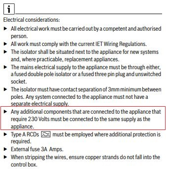

So if some thing is safe in 1950, and nothing has changed, then it is also safe now, but things have changed, in 1950 a boiler would not have come with the instructions like this
so today which the boiler that came with these instructions we must clearly report if there is no RCD and if the RCD is not type A. The instructions were pointed out to me when I said there was no real requirement to power the volt free thermostat from the same "circuit" as the boiler, it was pointed out it does need to be connected to same "supply" since most home only have one 230 volt supply it is unlikely that additional components could be connected to a different supply, and it is common practice to use a different circuit to power wireless thermostats to the boiler, Nest being a good example where a USB adaptor can be plugged into any convenient socket to power the remote thermostat.
Clearly this is not what the instructions were considering, but it points out the problem with English and in real terms the installer, and inspector must use common sense gained over their years of experience and not simply try and follow instructions and regulations, and so "potentially dangerous" is really could this become dangerous easily in the future, which is fair enough, but not easy to decide, I remember when the wagon MOT came in we had books issued which carefully laid out the limits, like a 1.5 inch king pin can allow ⅛ inch movement on the edge of the wheel, and I have seen fitters use a dial gauge to measure it where they could not get a replacement in time to see if it would pass.

I also have no idea why Worcester Bosch say a type A RCD must be used, so would lean towards issuing a code C2 for type A RCD, but my problem is not all boilers require a type A RCD and not all even require a RCD to be fitted, and it would be a huge amount to reading to find out which are which, so likely would only be a code C3. I would guess type A is because the three port motorised valve has diodes in it and uses DC to stall the motor in centre possition. But this is only a guess, and if correct then any RCD not marked type A when a Y plan is used would also be a code C2, which could likely mean 25% of homes would get code C2 due to wrong RCD type, or would this only be the case where the RCD is relied on, so only with a Y plan in a home with a TT supply?
