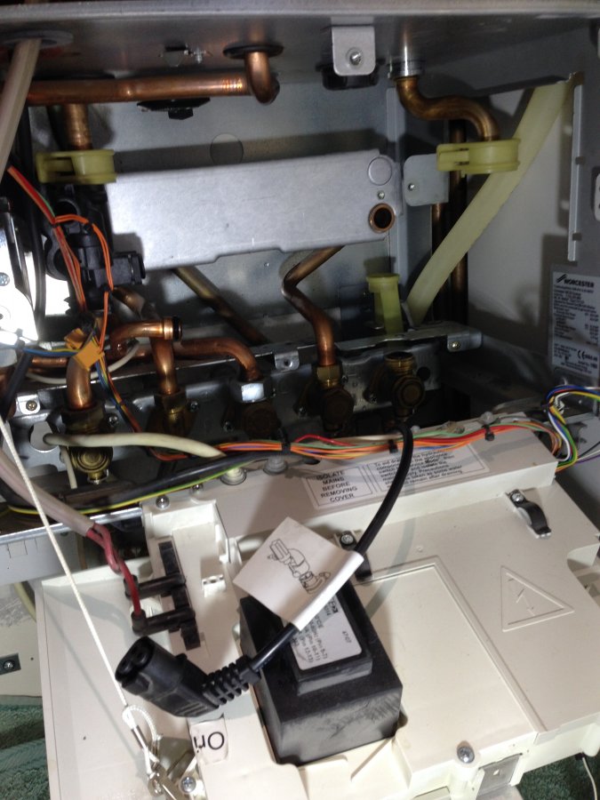

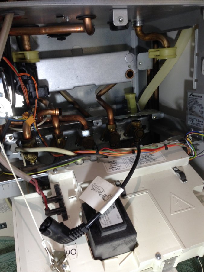

In fact, changing the PRV on this pile of shyte Greenstar this very day. The whole of the Hydro Block out, 2 visits to A&E for laserations & 4 hours later it's up n running.
Customer is saying Which magazine recommended it & I'm paying a fortune on repairs!!
All marketing w.nk mate, big company with big advertising budget & installers with limited experience or skill fitting them.
Complete rubbish boilers!!!
Yeah, ever try to change the PRV??!! Complete pile of shyte!!!
Yes, just usually get a set of grips up the back and replace the head. I have had to take the hydro block out of a junior once as the f&r pipes ran up the back and there was just no way. Oh and gloves :)

Need to brush up on yer skills puller, big time. Various ways to change prv
1) remove pump, 10 secs. Undo plate 2 screws, reach in and remove prv
2) turn gas off, remove gas ISO valve. Pop your little hot dog holder in behind and remove.
3) boiler off wall takes no more than 25 mins
Will pop back on tomorrow for more tips. Tell me what your struggling with and I ll get on it.
As for expensive parts, load of bullox, probs cheaper end spares in the industry
