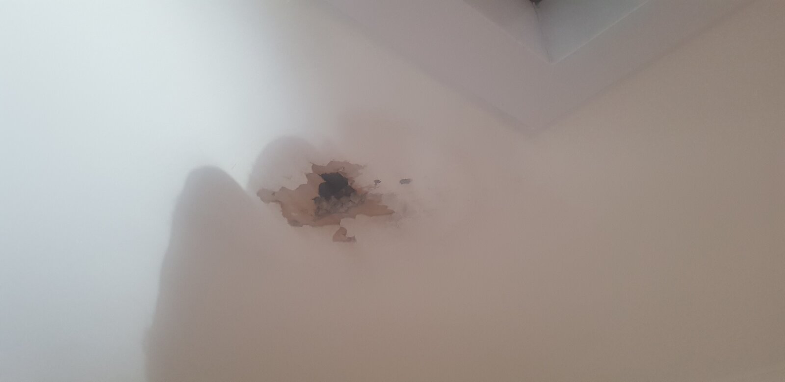

Disturbing this fitting to mask it made the rcd trip.

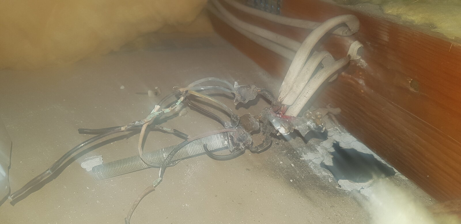

So yesterday my friend asked me to have a look and secure the base of the fitting which was held only by one screw.

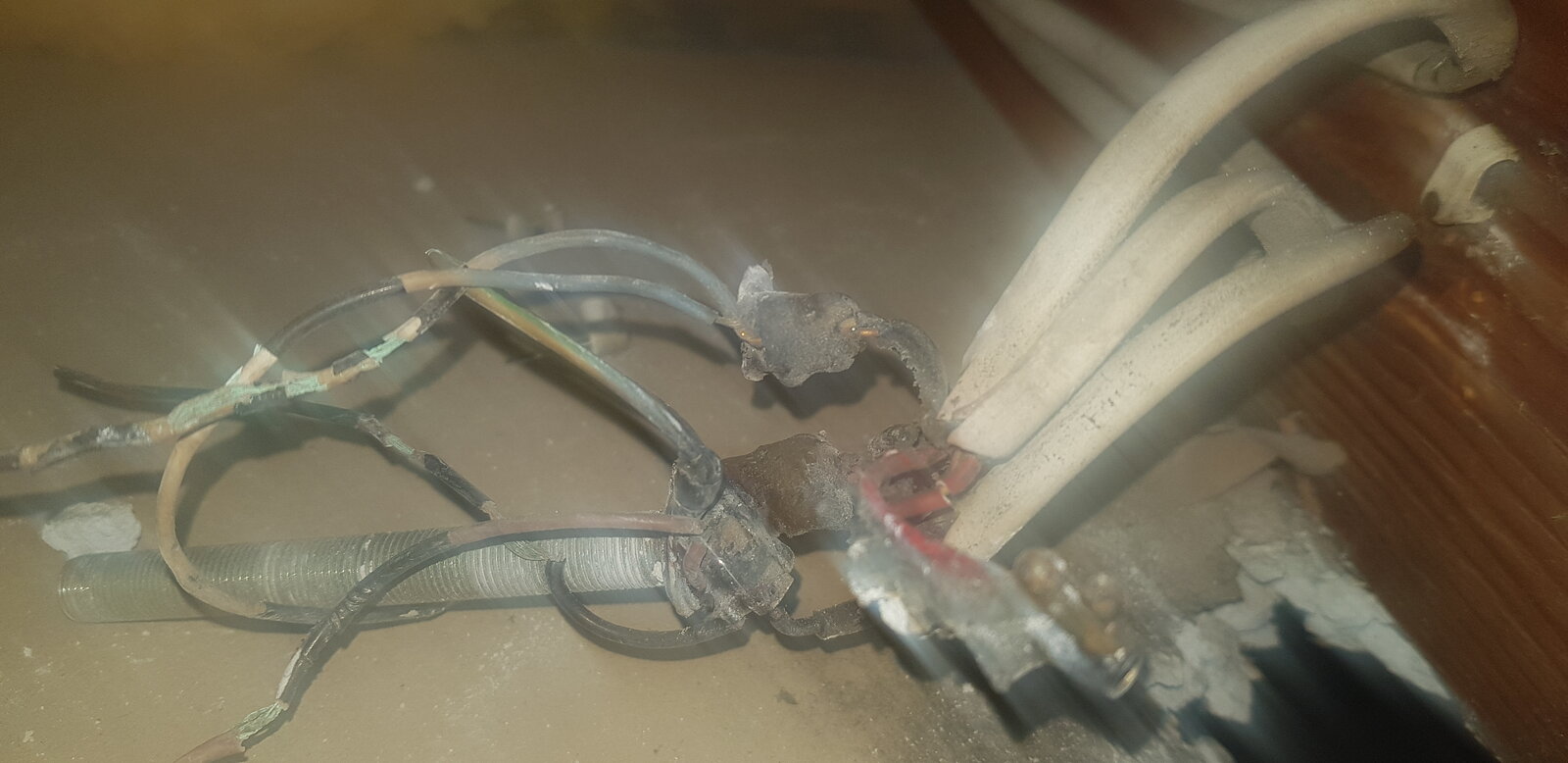

Being a metal light fitting I switched the circuit off at the consumer unit and found what you see in the pictures (sorry, not the best but you get the idea)
Bare live wires touching other wires and the fitting and worse of all, connections made with metal connectors dipped into hot glue :eek::eek::eek:
Of course only an inch of the wire peeks through the massive hole in the ceiling (for easy installation???)
Was this ok in the '80s???

Looks like terminal blocks that have melted rather than hot glue
I didn't think of that, you're probably right.
Quite unusual to see that type of fitting in a council house from new, plain pendant was always the norm, are you sure it had not been swapped at some time?
No, that fitting was there from the start.
Must be one of those jobs that they fitted whatever they could get their hands on.
Downstairs stairwell light has a standard ceiling rose with plain pendant, although now yellow in colour, still working.
An electrician is going there today again to check all switches, lights and sockets.
This is what he did yesterday...
More likely caused by the wrong lamps fitted, that style fitting was ideally rated at maximum 2 x 40w lamps
