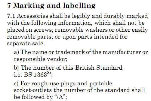

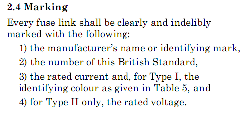

With the disclaimer that I do not have the current versions, and they may therefore have been removed,
this is from BS 1363:1984 Incorporating Amendment Nos. 1, 2, 3, 4, 5 and 6:
This is from BS 1362:1973 Incorporating Amendment Nos. 1 and 2:
And this is from BS 1361:1971 Incorporating amendments issued January 1983 (AMD 4171), January 1985 (AMD 4795) and January 1991 (AMD 6692)
So standards can, and do, require markings as part of conformance requirements.
