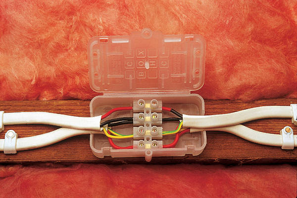

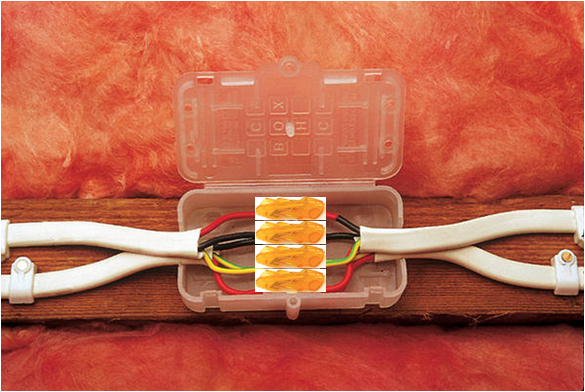

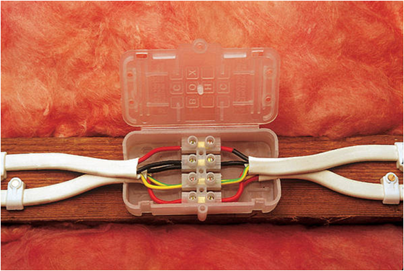

FWIW, my conclusion to date (always open to update because of new evidence).
If you want something which definitely complies with 526.3(vi) then you can go and buy a Wagobox + the "correct" connectors, or an Ashley J8xx, or the LINE product above, or any other product where the maker claims BS 5733 MF compliance.
If you want a bit more flexibility then IMO you could, for example, use different MF-type connectors inside a Wagobox (the nature of the LINE enclosure shows that tailored recesses for, or close restraint of, the connectors themselves cannot be a requirement).
Or you could use any MF connectors inside any generally compliant enclosure where choc-block (for example) would be OK, as long as you de-rate the connectors and provide cable restraint.
Clearly the "a la carte" approach would not be compliant with 526.3(vi), but you could still issue a valid EIC by documenting it as a departure. Given what we now know of the varied approaches to BS 5733 MF compliance I would have no problem in declaring that in I had exercised reasonable skill and care when carrying out the "design and construction" of the junction box and to the best of my knowledge and belief the resulting degree of safety of it was not less than that which would be obtained by compliance with the Regulations.
If this is OK
then so is this:
