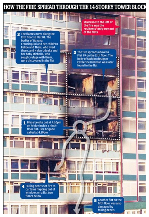

Fire spreads all ways, especially if so called highly flammable material is all around it
Ah, you mean like the Lakenhal fire went downwards.
Ooops, no it didn't.
LakenhalScreenshot_2019-11-19 High Rise Fire-fighting Lakanal House 2009.png

"Incorrect rating
But from the industry’s point of view, the inquest uncovered alarming evidence. The key issue was the installation of spandrel panels in the replacement window assemblies that were not rated Class 0 for surface spread of fire, as required by Part B of the Building Regulations. (Table 40 requires that all materials installed on buildings above a height of 18m must be Class 0.) The panels were able to ignite, burn through in less than five minutes and then introduce a flame source into Flat 79 an estimated 15 minutes after a television in Flat 65 caught fire.
The expert analysis of the fire came from Dr David Crowder of BRE Global, which has a contract with the Department for Communities and Local Government (DCLG) to investigate serious fires. Crowder later told CM: “Had a Class 0 panel been installed, I wouldn’t have expected that panel to have sustained flaming and allow the flame to pass through. If the recommendations in Approved Document B had been followed, this wouldn’t have happened.”"
