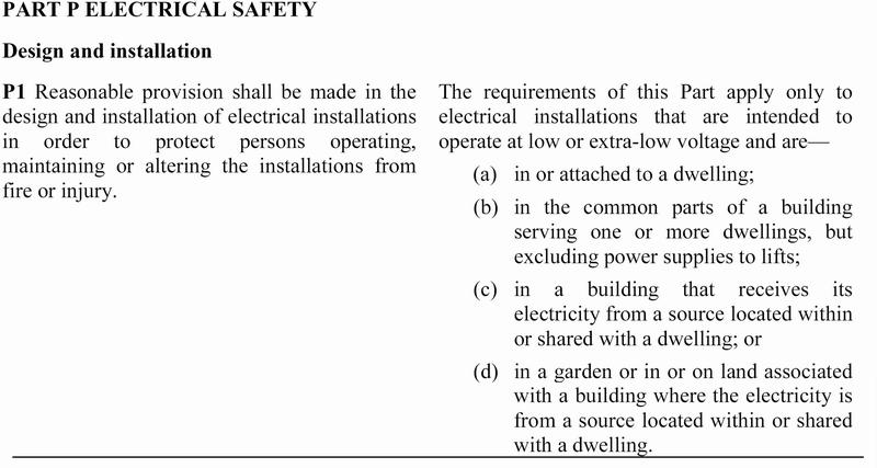

Part P is part of the building regulations. It is law but only states:
It does not reference the British Standard.
The approved doc does reference the BS but is guidance not law.
No need to go over all this again though //www.diynot.com/forums/electrics/part-p-notification-from-april-2013.357652/#2699164
I think you are referencing the British Standard and the Part P guidance? Part P is part of the building regulations. It is law but only states: .... It does not reference the British Standard. The approved doc does reference the BS but is guidance not law.
That's all correct, but the reality is that for the great majority of people (including the vast majority of DIYers), being able to show that they have complied with BS7671 is the only way that they can support an argument that they have complied with the law (i.e. Part P of the Building Regs). Only someone with considerable expert knowledge would be able to even attempt to argue that they had complied with Part P even though they had not complied with BS7671.
