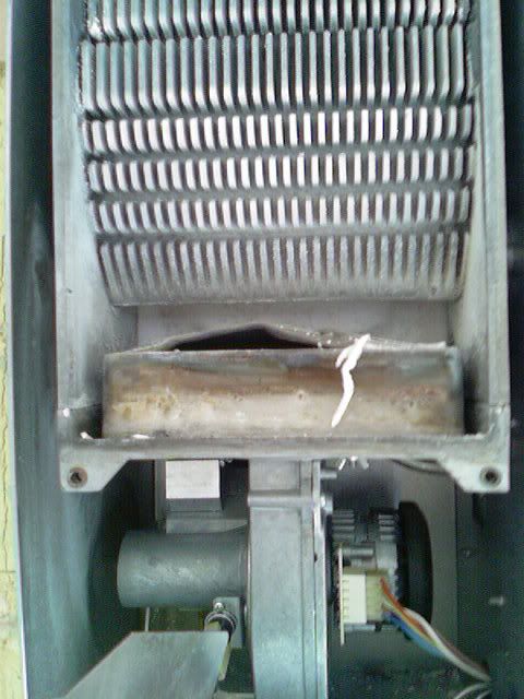

Went to this today which wasn't working.
When i got there it went through start up sequence, power to the gas valve but no ignition and couldn't hear sparking. Reset just to try a second time and....BANG. Mini gas explosion inside the fan, shooting a puff of smoke out the air inlet. Nearly had a heart attack at 21!
This is what i found in the CC.
Was obstructing gas to the spark electrode until it completly filled the CC.
Looks like £150 for a new burner then..
i dont think i have ever opened one of these up to not find the burner cracked. :rolleyes:
never seen one as bad as that though :LOL:
