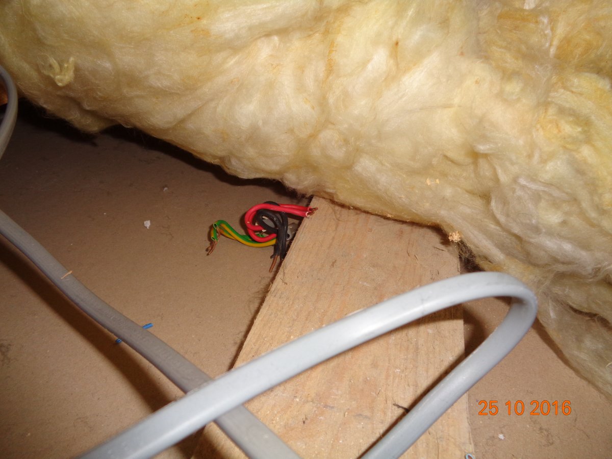

I've discovered a booster box in the loft wired to the bedroom ceiling light. I don't know who installed it and am wondering whether it needs checked out by a qualified electrician. Also,if it had been installed by an aerial technician would that be acceptable? (The cable from it leads down the outside wall into the bedroom)

I'm attaching some photos, rather concerned at the bare wires.
It's a little bit of a mickey mouse job. As Prentice has said, the booster is low power, so the lighting circuit can handle it. They've cut off the 13A plug on the booster, and wired it into the fused spur, but I suspect a 13A socket would have been more sensible, as there's a fuse in the plug itself. Okay, a 13A socket off the lighting circuit isn't exactly kosher, but I've done it for the same reasons.
Those bare wires are a cause for concern. Looks as if a wiring accessory has been removed - perhaps nothing to do with the aerial amplifier. If ther were connected to a socket on a ring final circuit, the ring is now broken. Can you see where those cables go, and do you have any means of testing for voltage?
We think something has been removed but don't know what. Decided best to have it checked out by a qualified electrician. I'll let you know the outcome. Many thanks for your replies
Do those bare wires come up through a hole? Looks just like the discarded ends cut off of 2 old cables from the photo!

and yes get those bare conductors checked out!
