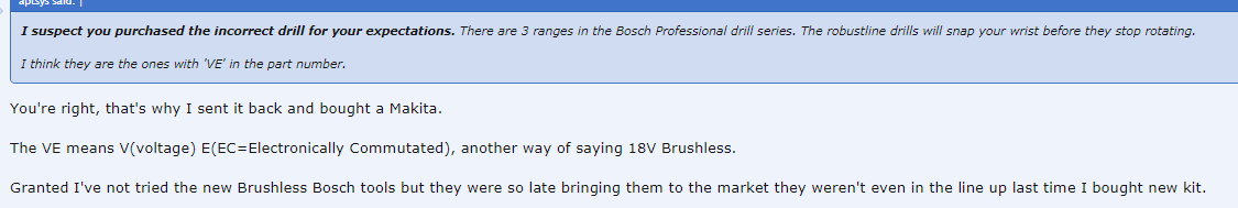

As said, the VE is simply the designation for the robust line of tools.
I design motor drives for half of the work we do. Brushless motors have their place, but if you look at the specifications for any brushless motor their peak torque is typically at far higher speeds than is useful for a power drill
I presume that you are aware that electric drills, both corded and cordless drive through a gearbox which reduces the speed (and increases the torque). By that means the manufacturers can tune the performance of the tool to the task at hand to an extent. Out of interest my old Stnley-Bridges corded drill (now 60 odd years old) actually runs at around 20,000 rpm - the output at the chuck is 2950rpm
Interesting misquote in your reply, SammyInnit. Try to quote with the correct context next time instead of talking out of your own arse.
I wasn't talking about what Bosch drill is the best or worst. As said I don't use them, I think they're rubbish so if you expect me to know the product details you're a bit naive.
I was specifically referring to the EC part of the Brushless tools they make and how on the other hand you're suggesting it's a marketing gimmick. Looking at their lineup of combi drills on their website, the only drills to parallel the 'VE' drills are the 'EC' drills. So either Bosch are just using marketing **** or you're contradicting yourself.
Their top of the line combi is infact a Brushless motor. GSB-18-VE-EC.
I'm not overlooking the 36v model I'm plainly ignoring because that is ridiculous. It's not 1999 any more.
I'm not going to argue with you anymore. Brushless are better than brushed. Bosch are crap. That's that.
