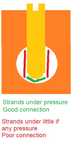

The reason I use ferrules is to ensure all strands have good contact to the terminal, both mechanical and electrical.
can become untwisted as the dome on the end of the screw pushes into the bunch and displaces some strands sideways and away from the contact area.
Which is the point of a tight twist - to resist that, plus the doubling over, to fill the terminal.

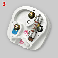

Not a big fan of this type of plug and never understood the fuss around it.
Always thought the cord grip was absolutely terrible on it.
Working in a school with a lot of old accessories around, if I encounter one of these there's always a strong chance the individual cores of the flex will be showing as the outer sheath has slipped out of the cord grip!
Better than most - the tighter the cord is pulled, the tighter it grips.
The terminals, offered a much bigger area of contact, if properly fitted, than the usual hole and screw, plus less damage to the individual wires. Always a favourite, when the appliance demand, was close to the 13amp limit.
I've never found them to be more reliable than other good makes and have never been happy with the unreliable cord grip arrangement.
