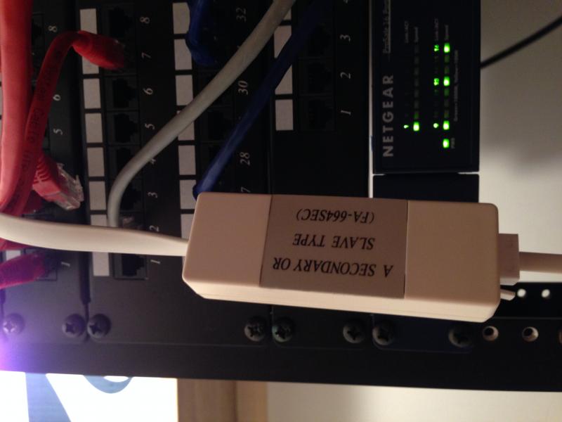

There's pictures of the master, the rear of the panel (where I have daisy chained the sockets) and the linemod

I assume that pink UTP cable bodged into the vDSL plate is just for your router/modem?

Yeah the pink cable is cat6. I wouldn't really use the term bodged. It is correctly installed, the issue is that it is on an RJ11 connector, and the cable is far bigger than the connector, hence the joint between the crimp and the cable isn't the neatest

On your pic of the rear of patch panel, where is the voice terminating?

It was just a case of cat6 being all I had. It's a 2 metre or so run, I wasn't going to buy another roll of cable just for that. On the back of the patch panel, the voice terminate further over, on a blank patch. I then run a patch lead from there into the first socket of the daisy chained sockets. I found that punching the voice lead down on top of the already terminated IDC's where I had daisy chained it didn't give a solid connection
Most would terminate the voice directly to the rear, punching down without cutting, so just one cable in the IDC terminals.
I can't see the voice termination note patch panel too clearly, but other than that, things look ok.
