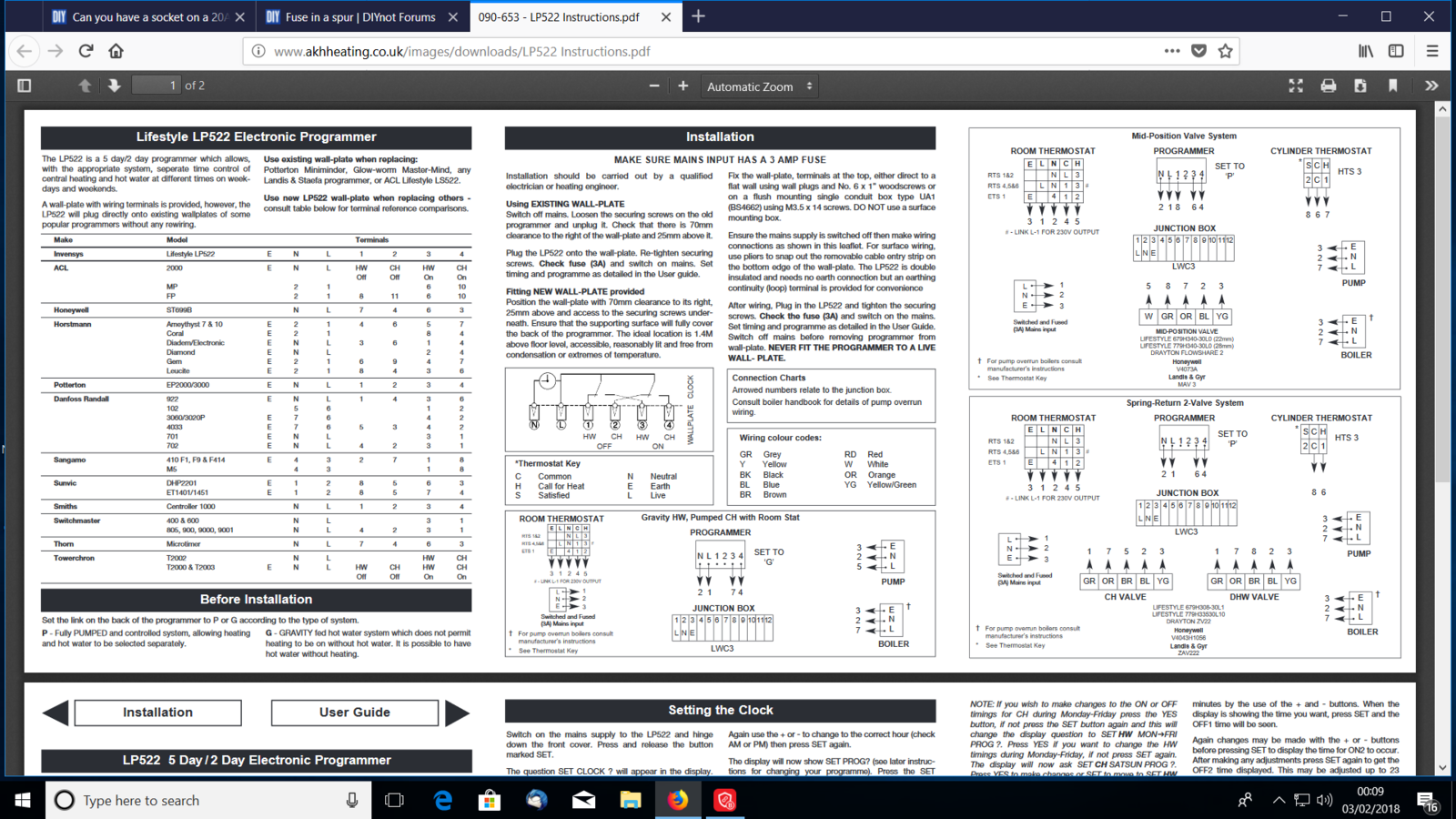

.....supplying the boiler and any associated components pump, thermostat, programmer etc as applicable. This should have a 3A (or 5A occasionally) fuse in it to protect the boiler.
WRONG. The fuse is to protect the cable between the FCU and the boiler. All reputable boilers have internal fuses for protection. If this was not the case how would boilers operate in other countries where FCUs are not available or compliant?
That's what we are discussing - should you have a 3A fuse or not?
IF the regulations say you should, then you should, and what regulations in other jurisdictions say is of no concern.
IF the regulations do not say that you should, then you don't have to - we all know that, and have no need to concern ourselves with what the regulations in other jurisdictions say.
The external components are supplied via the boiler. The fuse is to protect the cable to the boiler as I said. Manufacturers instructions are for guidance only and don't have to be followed if they are wrong as they clearly are in this case.

These installer instruction stipulate 3 times to check the fuse (3A)...
