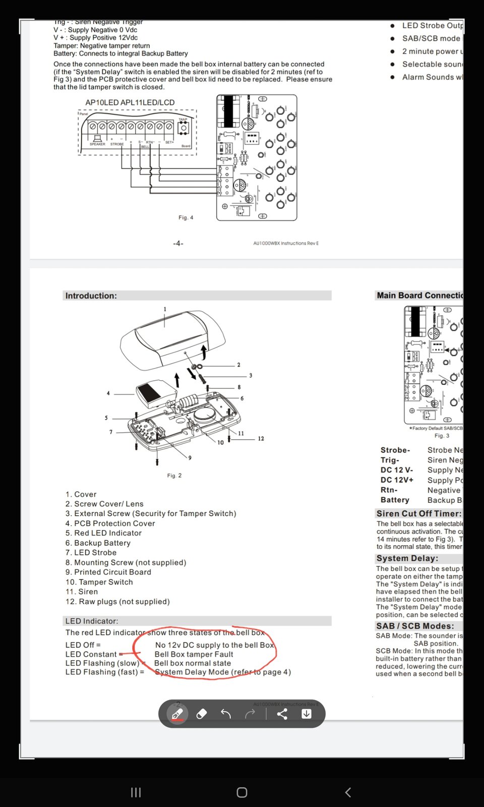

then a few weeks ago was getting some work done outside and they drilled near the bell box which set the bell box off and the internal siren, I stuck the code in a few times but it didn’t stop the bell box for a minute or so after sticking it in. The bell box seems to have a continuous red led on it, anything to worry about ?
Included a pic of the panel
24h led shows tamper fault.
Drilling near bell box which caused sounder to activate would suggest issue with tamper switch on bell box.

Faulty bell box or tamper switch needs adjusting.

Potentially yes, internally my activate if tamper goes secure and active, externally may self activate. Not familiar with bell box you mention
