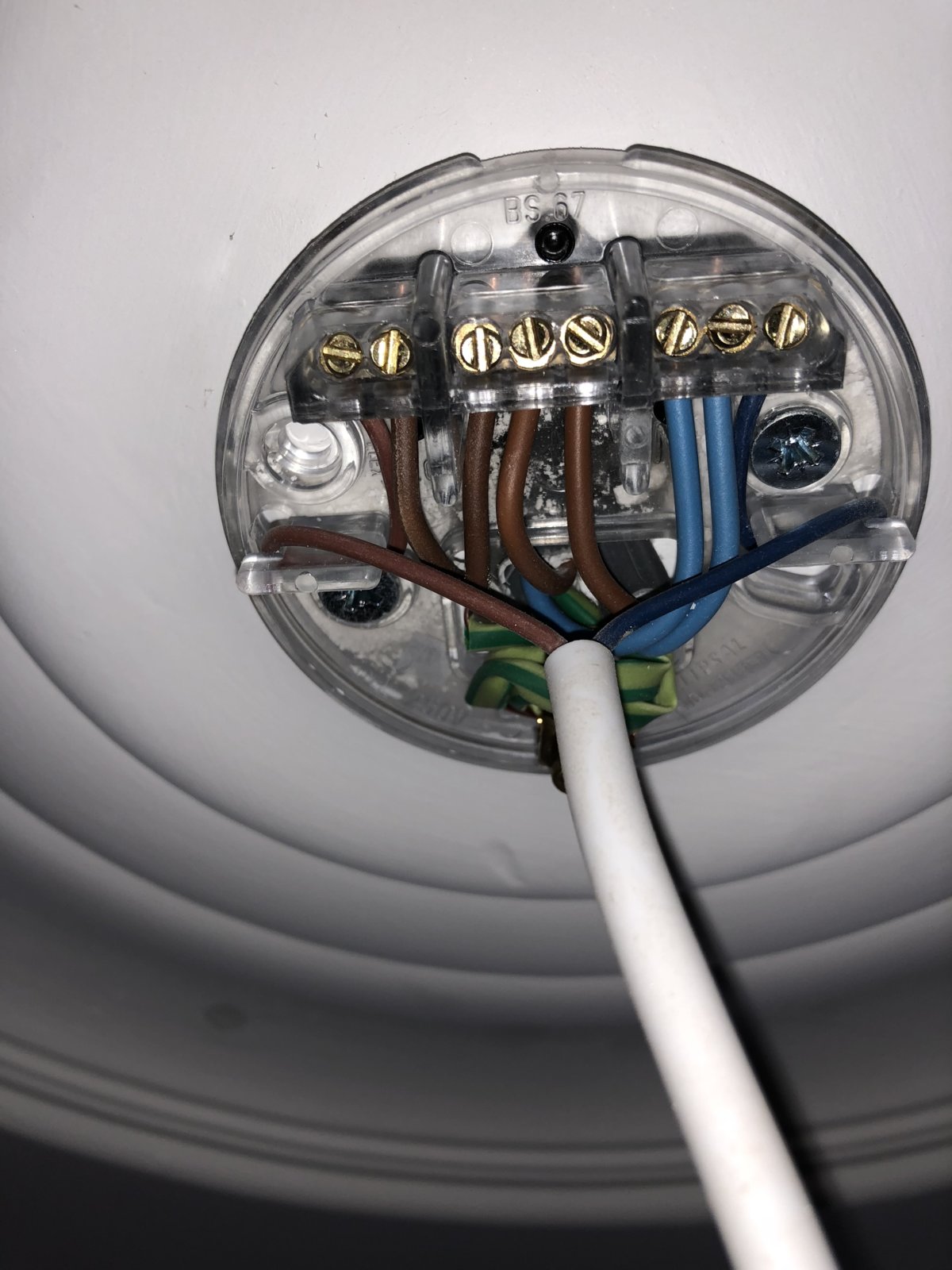

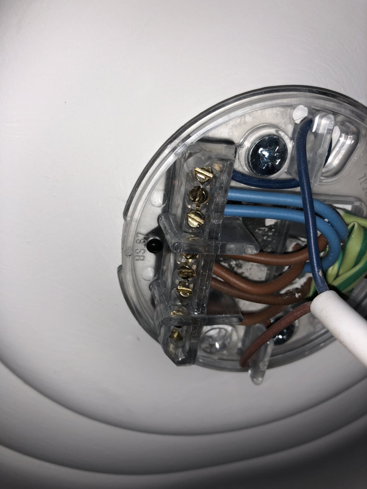

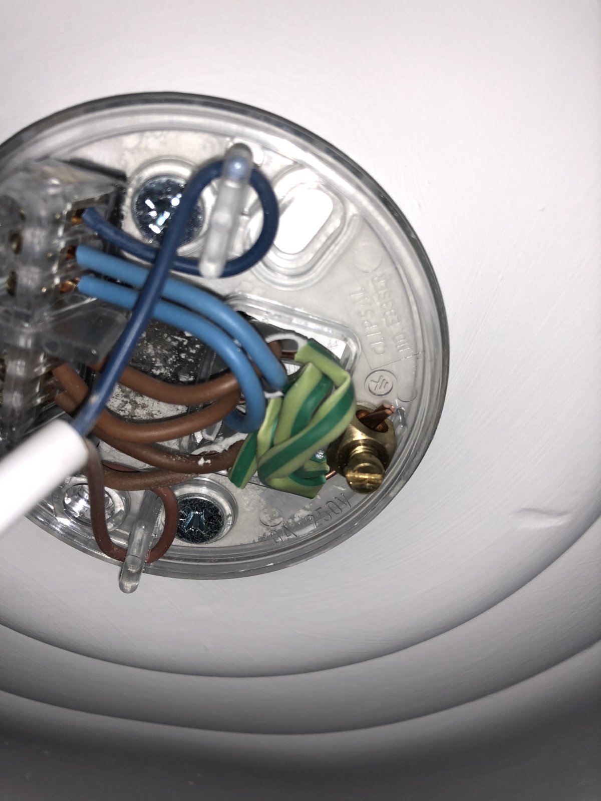

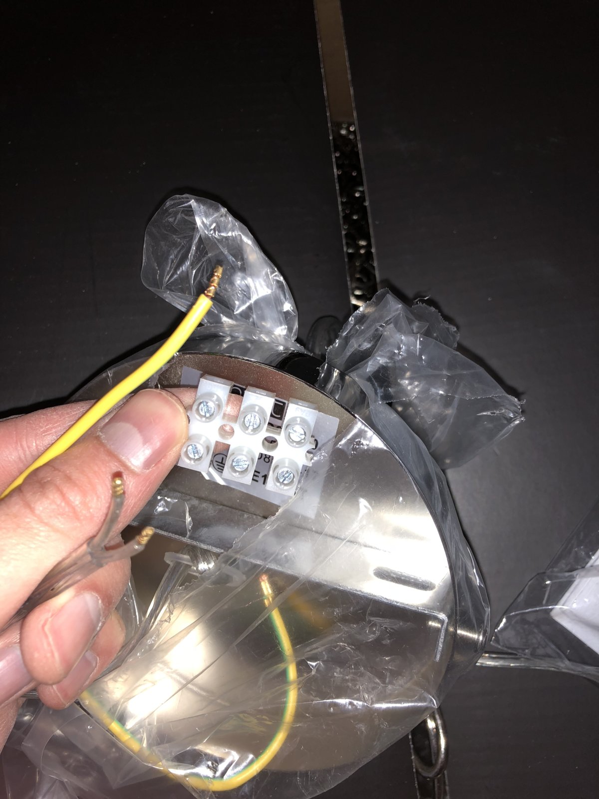

Hi guys,
Just wanted some advice about changing/wiring a pendant light (photos attached).
Basically how do I wire it? No instructions in the box - not sure if the terminal block supplied is big enough.
Cheers for any advice!

Thanks ‘Ban-All-Sheds’,
Had a look at that guide - thanks.
Just to clarify - which brown wire (on my wiring) will I know to put into the terminal block. And which of the other four brown wires will I know to tape together?
You do not "tape any together".
The tape in the diagram is over a connector block. The tape is not necessary.
Study the link. It is exactly the same as what you have - albeit the other way round left to right.
