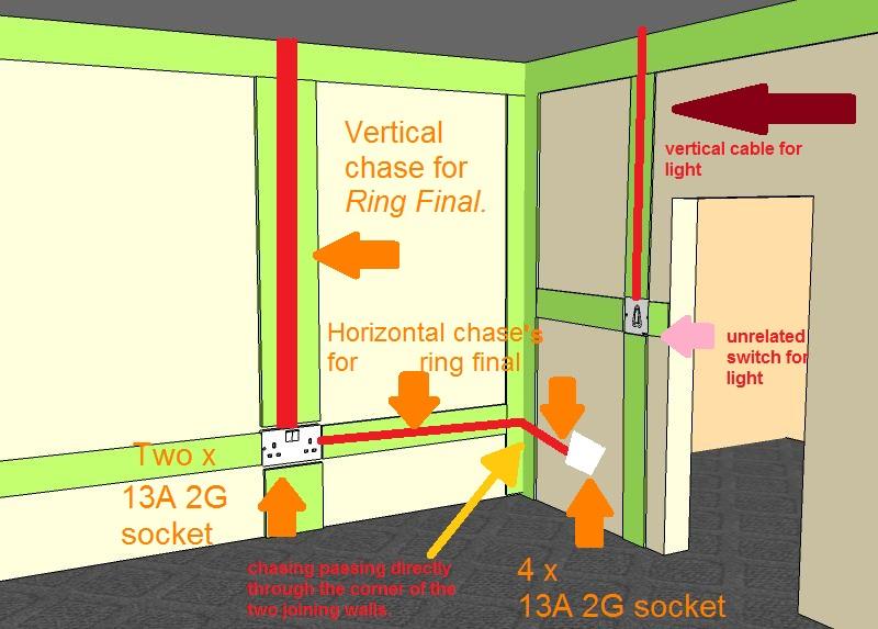

Somehow I don't think anyone is understanding my question, so I've made a new image that might explain things better.
As you've already been told, those cable placements, within relevant safe zones, are fine.
I'm a bit confused by the "Two x 13A 2g sockets" and "4 x 13A 2G sockets" - are we really talking about a total of six double sockets?

Thanks for the clarification John.
Yes we would be talking exactly six double 13A sockets.
Thanks for the clarification John. Yes we would be talking exactly six double 13A sockets.
You're welcome. So do you mean, per the diagram, a pair or double sockets next to one another on one wall and a group of four doubles next to one another on the other wall?
Kind Regards, John
The cable passing through the corner wall is not really relevant in this case, as the safe zones will be made/determined by the accessories mounted on the two walls, with cables running horizontally.
You could in this instant maintain the continuity of the circuit by going vertically down and up from and to sockets, using the floor void as the route.
Providing the floor is not a solid one. But then you would also require to conform to the installation techniques for hole joists if required, notching and safe plates (the latter is not good practise but sometimes can not be avoided). Oh should I mention that! or issue a Hi-Jack alert!
