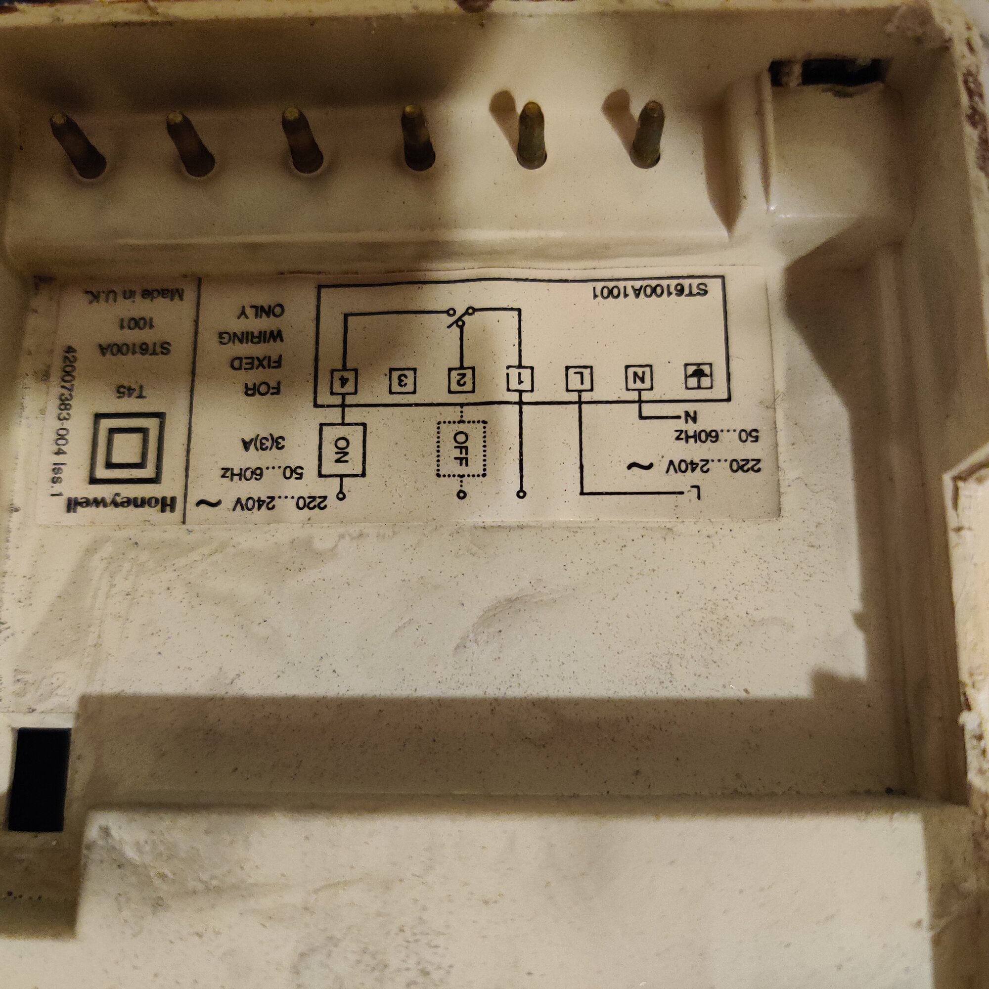

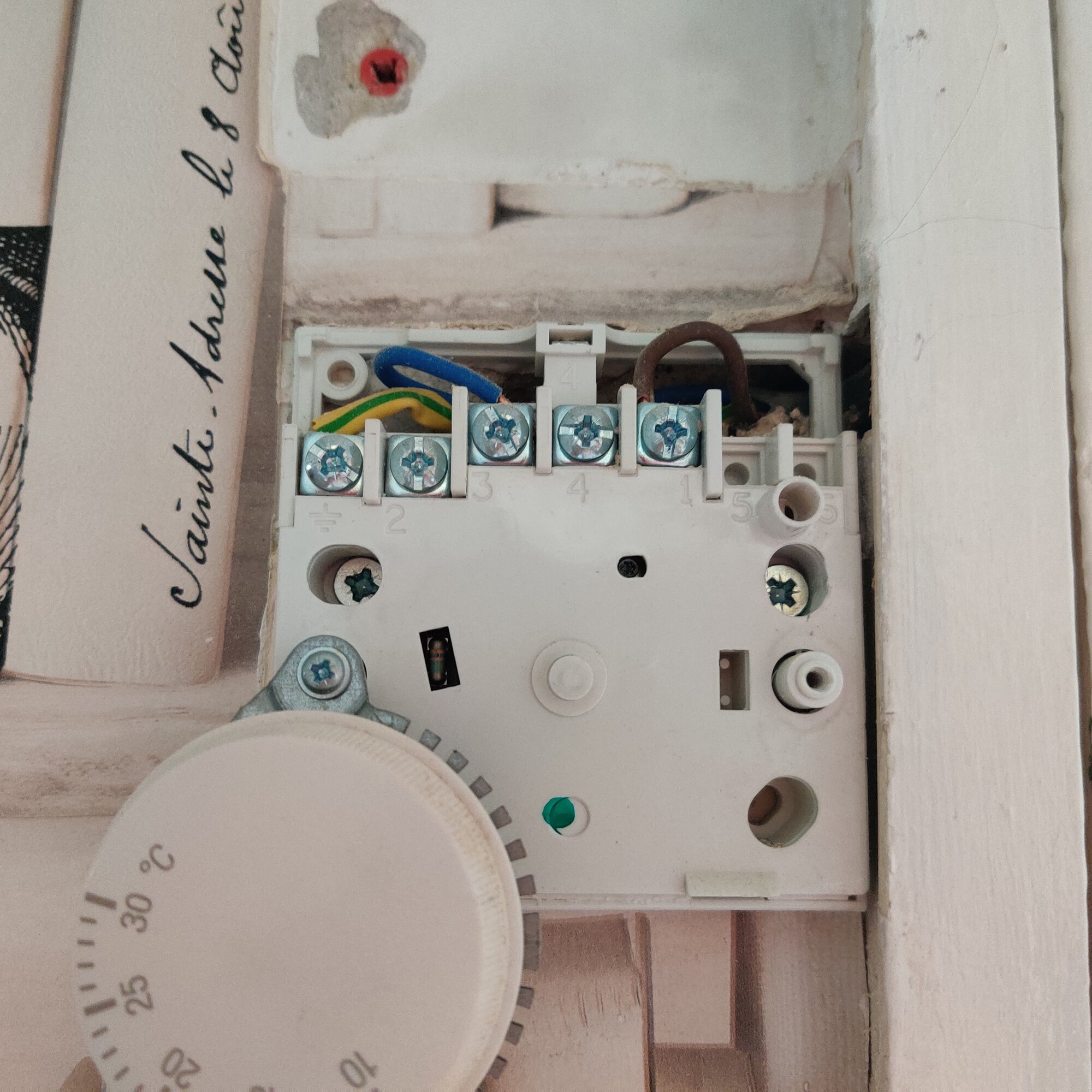

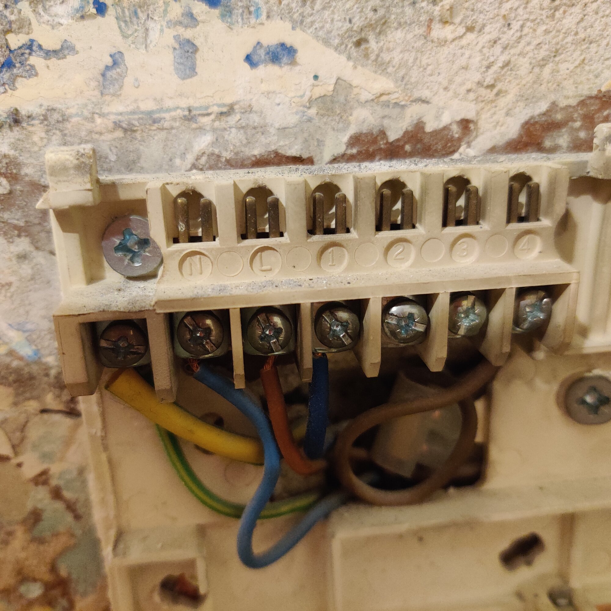

I have a Honeywell timer ST6100A with a frost room thermostat and a combiner's boiler 24i green star junior. The timer controls hot water and the room thermostat controls central heating. I need help wiring nest heatsink instead of timer and nest thermostat instead of room thermostat please! There is a spur of a 3amp fuse.
Here is the timer:
Here is its wiring:
Here is the thermostat:

On the timer N L 1 and 4 will go to N L 2 and 3 the N and L must go to right place. 1 should got to 2, and 4 should go to 3.
However some where behind the timer there will likely be some connectors where the cable to thermostat is connected, and the problem is going to be working out which those wires are and since with Nest Gen 3 those wires will be 12 volt and with original likely 24 or 230 volt clearly you can't afford to make a mistake, I used a multi-meter to check my cables were not connected to 230 volt before reusing them to carry 12 volt from heat link to Nest thermostat.
I think the boiler you have is Bosch and I don't think Bosch have signed up to Opentherm so you only have option of on/off control with Nest, it was same with my Bosch boiler, however I would not be happy reusing cables without using a meter to ensure I had the right ones.

L Honeywell to L Nest
N Honeywell to N Nest
1 Honeywell to 2 Nest
4 Honeywell to 3 Nest
Disconnect the thermostat wires from connections at timer, and use these 2 wires going to T1 and T2 - Doesn’t matter which way around, there’s no polarity. Remove wires at thermostat, and install Nest backplate and fit wires to T1 and T2 terminals. Since the earth is there, I think you need to connect this both ends of Nest as well.

1st and foremost, safely isolate and confirm.

Hi Chris,
somebody mentioned that if T1 T2 didn't have a supply of 12 V then it would blow the nest?
My trouble is identifying which wires are T1 and T2.
When I removed the box I found another set of wires, fine wires, in a junction together one grey and one brown.
Hi Angela,
Just gone over the post and Eric said make sure you don’t connect 230vac to the 12v side. The T1 and T2 are the brown and blue at your existing thermostat end (hence Eric’s comment). You need to remove the existing thermostat, Brown, blue and green/yellow, and connect them to the nest thermostat base plate then at your timer end, you have brown and blue which are common and call for heat, and the thermostat is connected somewhere.
