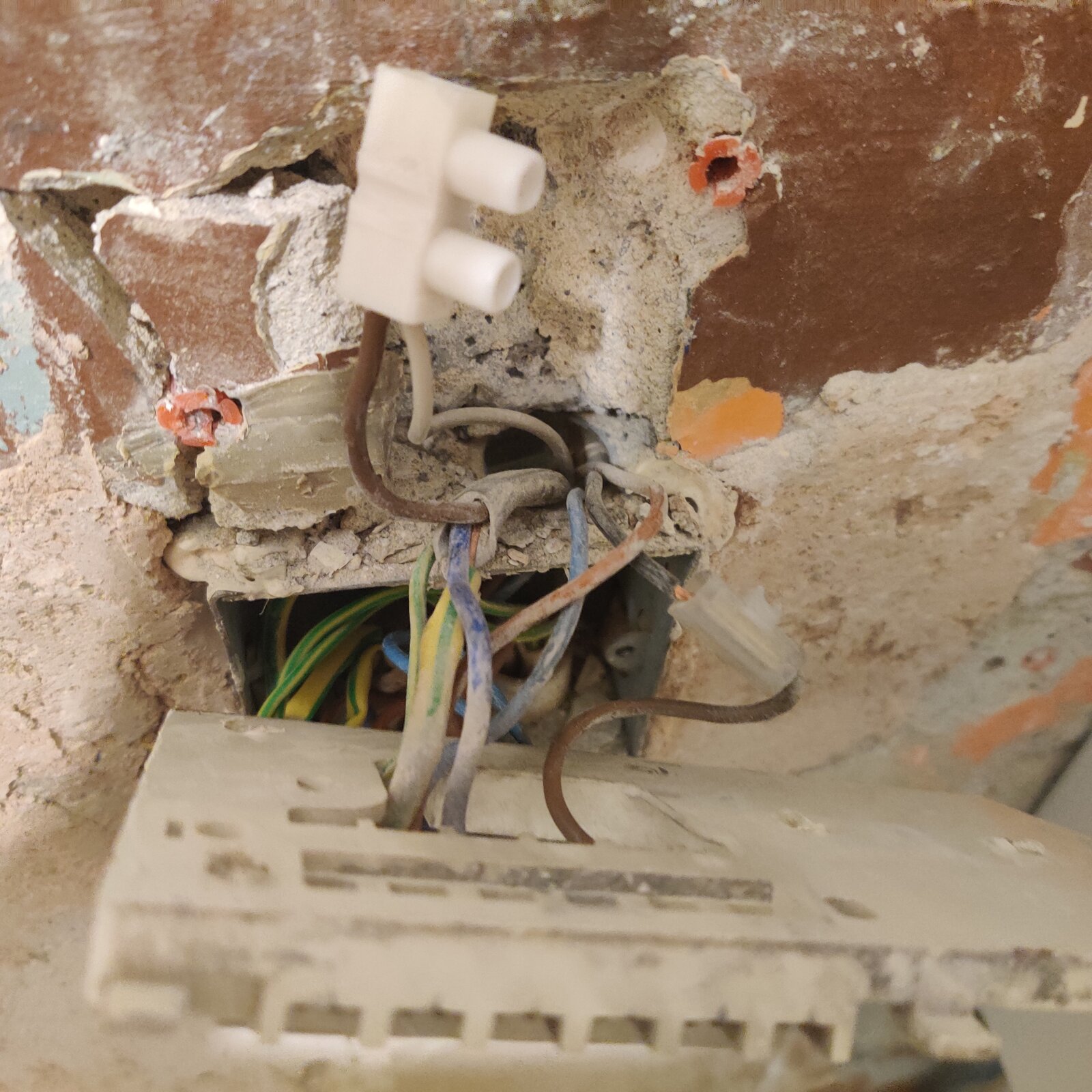

Hi Angela,
Just gone over the post and Eric said make sure you don’t connect 230vac to the 12v side. The T1 and T2 are the brown and blue at your existing thermostat end (hence Eric’s comment). You need to remove the existing thermostat, Brown, blue and green/yellow, and connect them to the nest thermostat base plate then at your timer end, you have brown and blue (same as thermostat) and these go to T1 and T2 heatlink end. The live and neutral are obvious.
Hi Chris thanks for your help. Please bare with me am bit slow.
So I take:
N Honeywell to N Nest
L Honeywell to L nest
1 Honeywell to 2 nest
4 Honeywell to 3 nest
My confusion:
Earth Honeywell to ?
What goes to T1 and T2?
Thanks again
The box with grey and brown - is this behind the timer? Might be the thermostat
Hi yes they are behind the timer joined together into a little clear plastic junction thingy, thanks
Does the existing thermostat work? It might be a bit trickier than I 1st thought. The existing thermostat wires could do with being traced. Failing that, you could always use the thermostat on a plug/usb for now and wire up the existing?
Thank you for your help, do you mean I can use the nest stand with USB connection instead of the room thermostat and replace the existing timer/programmer by heatlink following the wiring above?
really appreciate your guidance
One last thing, the existing room thermostat will need to be set to max and let Nest take it over, so leave all existing room thermostat wiring and then set it to a Max, and Nest will then take control of temps.

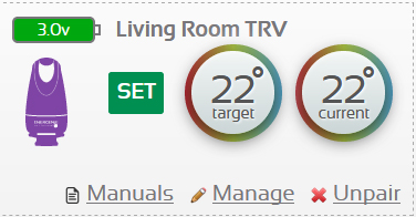

The Energenie still make their own wall thermometer so I would assume that still works with their TRV heads, I can see your point, you set the wall thermostat and that in turns tells the TRV what setting is required, and as long as the boiler does not switch off, that in theory should work. But once the boiler turns off, it does not matter what the setting is on the TRV, it can not heat the room.
So you have this
from the TRV, and if the target is above current valve needs to open and boiler to run, and if target below current valve needs to close, but boiler may still need to run to supply another valve.
So if any of the TRV's Over_all_report.jpg show current under target then boiler should run, and only when all are satisfied should boiler stop. There is no need for the wall thermostat to be connected to internet, only the TRV heads need to be connected to internet, so you set each room, and they tell the hub/wall thermostat if boiler needs to run, and that tells boiler.
