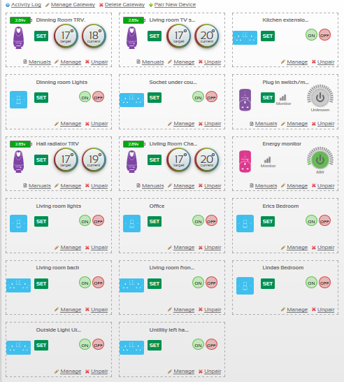

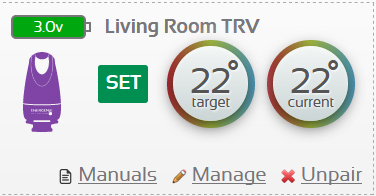

So you have this View attachment 217586 from the TRV, and if the target is above current valve needs to open and boiler to run, and if target below current valve needs to close, but boiler may still need to run to supply another valve.
If you can have a radiator valve open and close itself and also signal a boiler to fire/go off/modulate based on the temperature it is detecting then you can have a device on the wall which can tell a valve to open and close and also signal a boiler to fire/go off/modulate based on the temperature it is detecting.

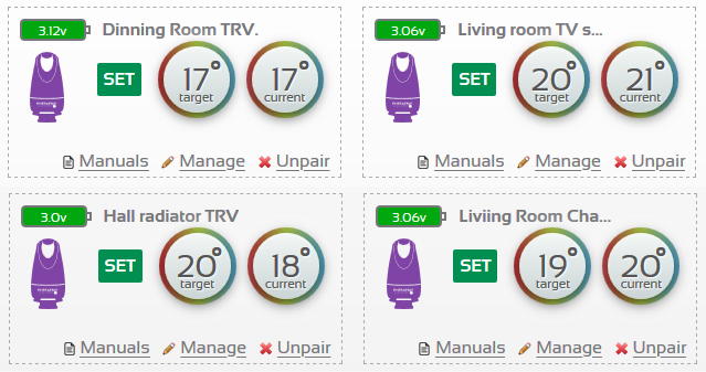

So if any of the TRV's View attachment 217590 show current under target then boiler should run, and only when all are satisfied should boiler stop. There is no need for the wall thermostat to be connected to internet, only the TRV heads need to be connected to internet, so you set each room, and they tell the hub/wall thermostat if boiler needs to run, and that tells boiler.

The TRV shows this TRV-report5.jpg on the PC, so we want some thing that says if any target below current then run boiler, there is no need for a wall thermostat, and in essence that is what evo home does EVO-home1.jpg and the cleaver bit where the algorithms say last time it over shot 1°C so this time start reducing the heating a degree earlier needs to be in the TRV head, which is the case with drayton.

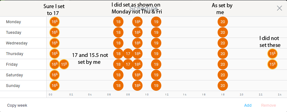

It seems to have a mind of it's own, and clearly it only changed the Nest not the TRV heads so the changes resulted in no longer were the two lined up. I had some problems with the boiler locking out, so it thought boiler ran for long time with no temperature increase, I assume that is what caused the unit to alter and add to the schedule?
The 18, 18.5, 19 is because the wall thermostat is not that close to the hall radiator, so it tends to over shoot, so the stepped raise stops it over shooting, but go out and geofencing turns off heating, so still over shoots on return.

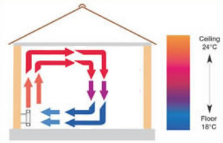

We have like most houses rooms with doors, and the radiators in each room naturally circulates air, circulation3.jpg so good place to monitor air temperature is the air returning to radiator, be it a fan assisted like a Myson or conventional with a TRV added, specially when the TRV has two sensors one which compensates for water temperature.
