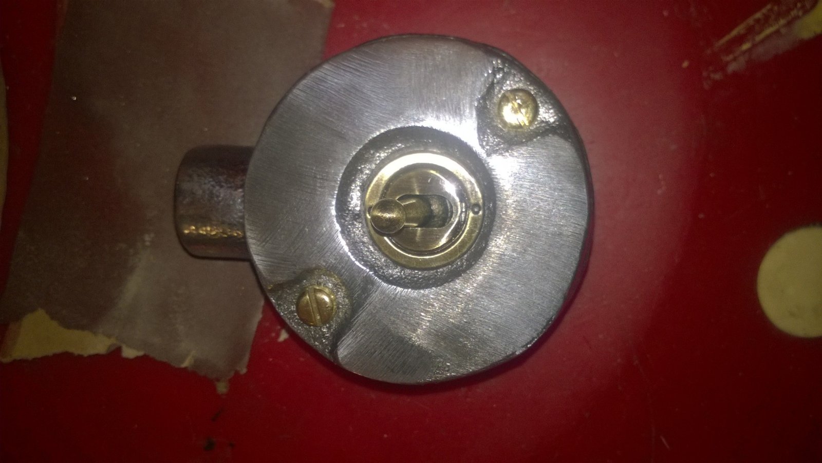

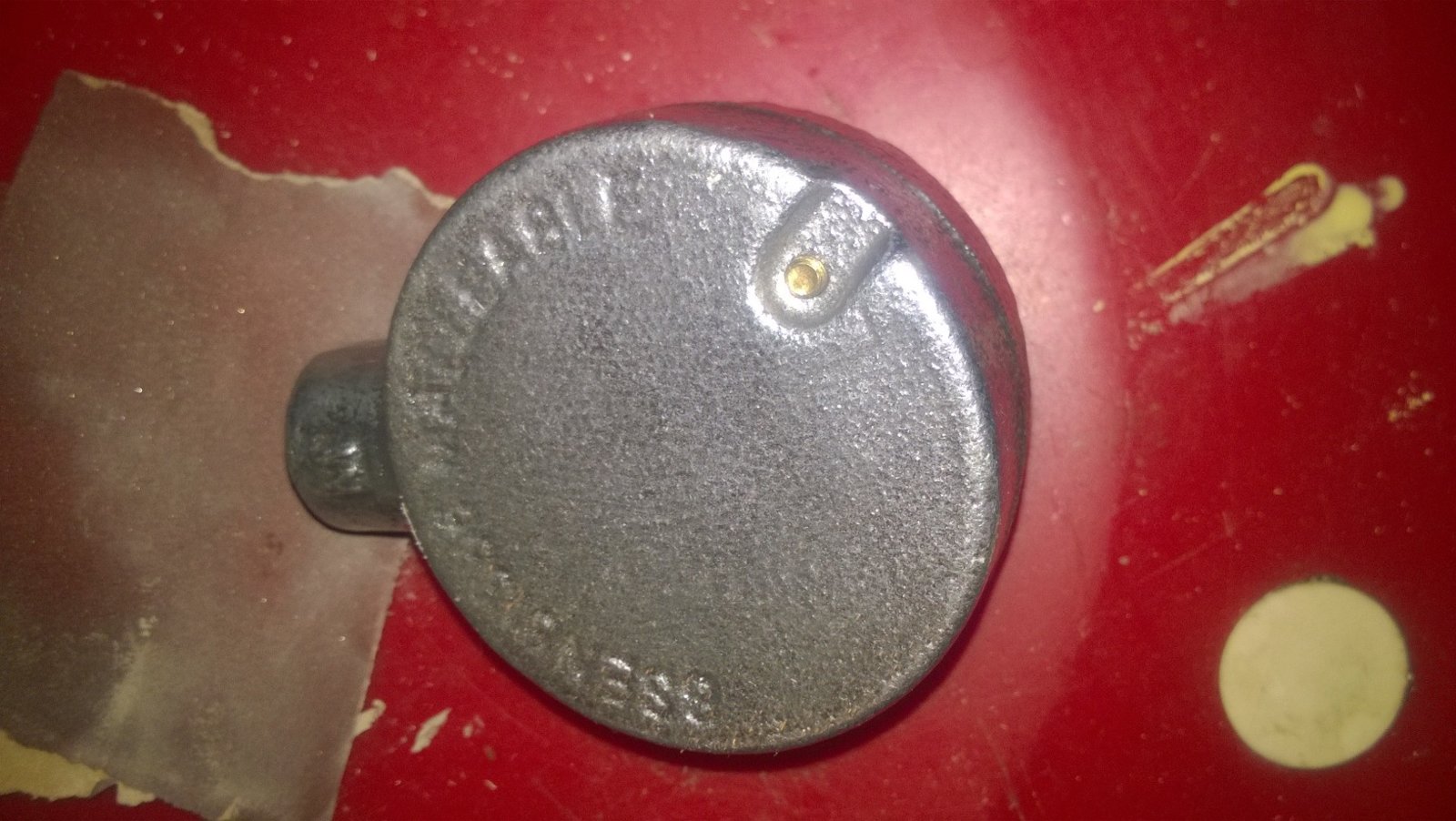

I have to fit a cast metal light switch to a brick wall. There are no screws holes on the reverse so I assume its only support will be the conduit pipe that takes the wires and is screwed into the top of the switch.
This will be about a metre long and will need support from a couple of spacer bars. The wires simply run out of the ceiling so will the spacer bars be enough to support both the conduit and the light switch ?
Or is there another way of securing both the pipe and switch ?
A cast metal light switch.
What is this, some relic of a thing?
If it doesn't have fixing holes, was it intended to be 'cemented in', like recessed boxes were years ago?

I don't think spacer bar saddles will hold the conduit firmly enough if the switch box isn't secure.
Crampets may hold the conduit better though, and look all rustic/old fashioned/whatever effect you are trying to achieve.
Yes it a repro outer casting so you may be right. I will try drill a couple of holes in the back and fix it to the brick wall then use the crampets to hold the pipe Thanks

That doesn't look like cast, that looks like a galv conduit box which can easily be drilled.
It says that it is cast aluminium, which seems quite credible to me (and which can be drilled even more easily than galvanised steel).
Looks metric so not old old.
It also said that it is new (made to order) and compliant with BS EN60669-1.
Kind Regards, John
I think the box is a standard off the shelf steel end box - it appears to say "MALLEABLE" on the back. The switch plate may well be ali, but that's almost irrelevant as long as it's a dry environment.
And for the OP - both the switch plate AND back box must be earthed, just needs a short connection between the earth terminal on the switch plate and the terminal in the box (in addition to connecting to the earth in the cable).
Maybe they are lying but, as I said before, the listing says that it is cast aluminium and that it is 'made to order' (i.e. not 'off-the-shelf') ...
Kind Regards, John
It's a cast aluminium plate with a switch mounted in it. Supplied with a standard galvanised cast iron conduit box.
The plate and switch are made to order. The box is a standard item.
