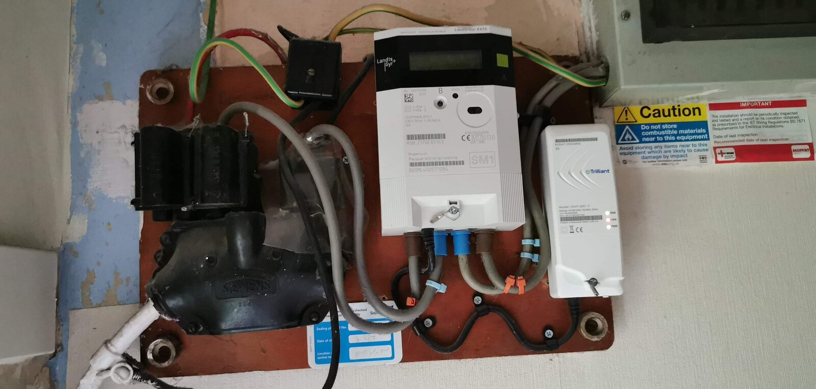

Hi all been requested to install a shower into house first time I have not had spare fuse in situe normal just stick to upgrading replacing current systems ins fuse system is BS3871 no extra fuse in spare slot so the obvious choice is installing a second consumer unit.
I reckon the system is a TN-S system see picture attached.
looking at adding Henley blocks 25mm tails from meter side to both consumer units and 16mm earth to earth block.
The 1way CU will have 63amp RCD and a 40amp for the 9kw shower.
10mm cable to 40amp double pole switch installed in cupboard.
Obviously the main fuse will have to be pulled for safety. Is the above the only option to me or is Thier another option without pulling the fuse that will still comply to BS7671 and be safe.
Any advice is much appreciated

The fact that you say, "I reckon the system is a TN-S system see picture attached." fills me with dread.
If you are electrically competent surely you should KNOW what system it is, rather than RECKON?
Is the picture included in the hope someone will confirm your reckoning or state that it is actually something different?
It does seem to be TN however as to if TN-S or TN-C-S only the DNO can tell you that, not that it really matters that much, so a smart meter will send a signal back if supply fails so really you can't draw the DNO fuse without them knowing, so you clearly need an isolator or other method to remove supply to work on it, and re-instating old systems presents a problem, your going to have to sign to say you have worked on the system and it complies with current edition.
I have heard the argument that the DNO should provide an isolator so you can isolate else where, so if they are breaking rules why shouldn't I so I will draw the fuse, however two wrongs don't make a right, and although some times the DNO do seem to turn a blind eye to fuse removal that is not always the case.
What I have done in the past is feed a second consumer unit from first one using the largest MCB that will fit, however since then we have gone to RCD protection of all circuits and metal consumer units, however since either you are a scheme member or have notified the LABC the way forward if uncertain is to ask your scheme provider or LABC inspector, not ask on a forum. You pay a lot of money to the scheme provider so why not use them?

My question may have sent mixed message. I would call local DNO regarding fuze. The consumer unit MCB are BS3871which are no longer allowed as per BS7671, is the best option fitting a 1way CU 63amp RCD and a 40amp for the 9kw shower.
Fitting new tails via Henley blocks for new CU or is Thier another way to install the system. Trying to keep costs down for customer if i can. I'm still learning after passing exams so just thought someone might know a different solution
Read more: https://www.diynot.com/diy/threads/confirming-system-and-install.548346/#ixzz6RE50sMgd
It's one option.
There may be others.
All depends on what's already installed and what the existing consumer unit is and has in it.
Whether this shower can be installed also depends on the existing installation loads and the rating of the supply.
A lot more information is required.
