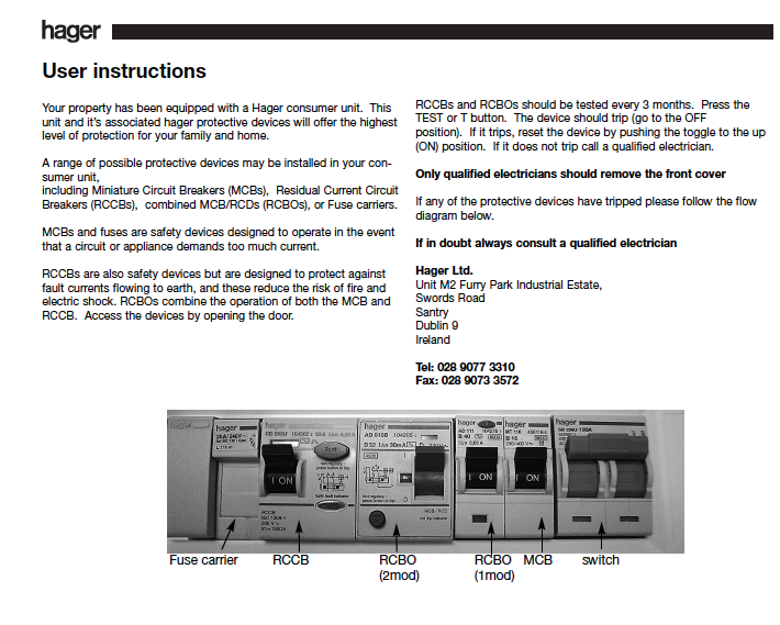

Browse the Hager product information. It clearly states their CUs can accept fuse carriers, MCBs, RCBOs and RCDs.
Thought I would actually post this, just in case kai cannot find it:p

It just seems pointless to mix up breakers and fuse holders on the same din-rail - The switch-fuse in the meter tails can safely handle the high PFC issues, so a breaker-only consumer board seems the ideal way forward, as there are B, C and D type breakers available. Note that MK do not make fuse holders for their boards at the present time.
PFC is not the issue. Most installations do not have a switch fuse to begin with, and the fuse in a switch fuse has a higher breaking capacity than any MCB. What's your point?
Do you really think if it was 'pointless' then manufacturers would make them?
There are times when you need a GUARANTEED method of disconnection of supply. I have experienced MCBs that have not opened under major fault current, I have never experienced a fuse to not open. Yes a 13A fuse in a plug may not operate before a breaker in some/many cases. But a fuse does not go faulty, it may become tired and blow before it should if it's abused, but if you apply a thousand amps of fault current to a teeny tiny piece of wire - it's going to melt away
I also note that MK do not offer a 3P+N distribution board. Is there a similarity there?
I also note that Hager currently offer 4 different types of fuse carries. Three for BS1361 fuses, and one for HRC BS88 fuses.
Must be pointless. I'll have to ring them on Tuesday and tell them to stop bother making them.
