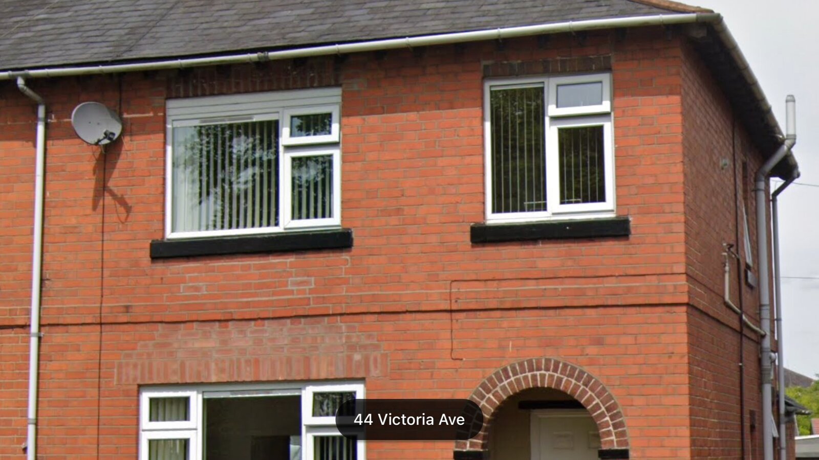

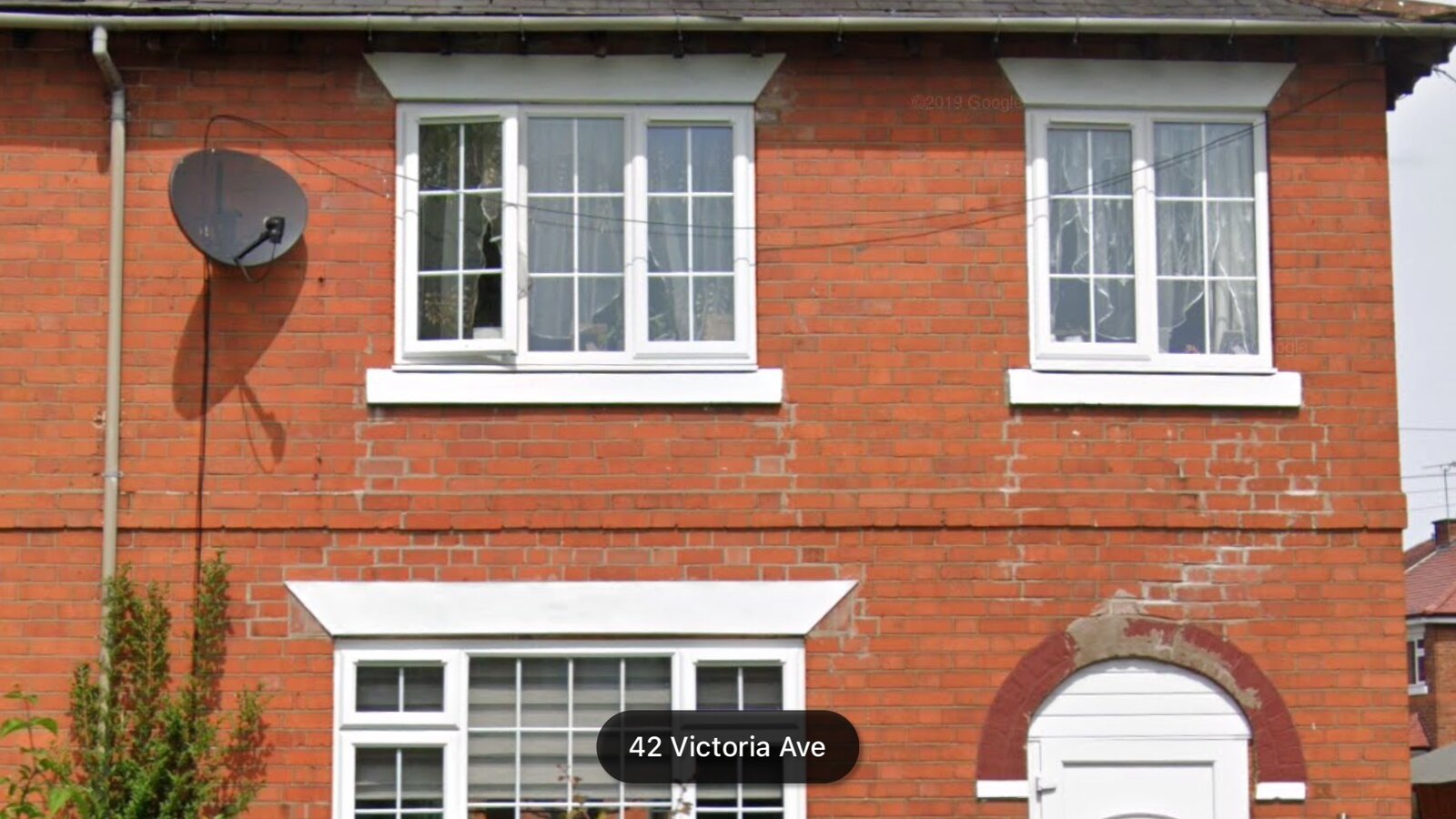

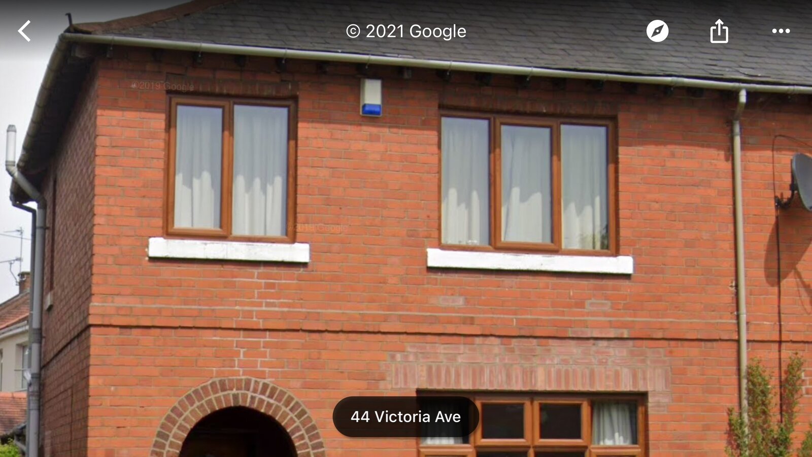

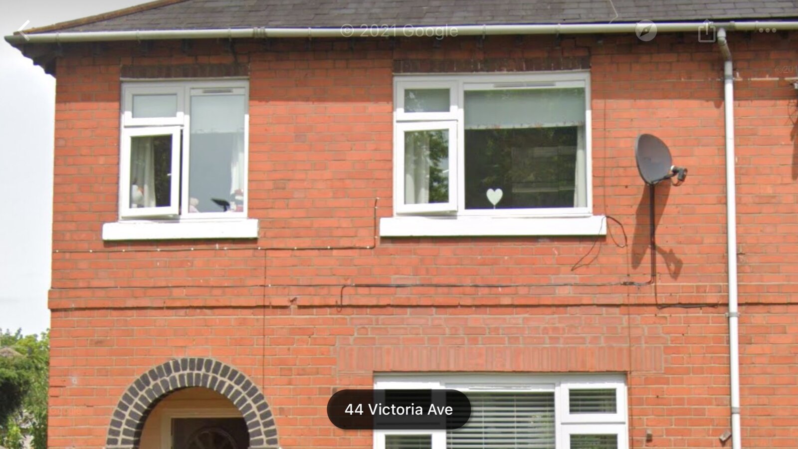

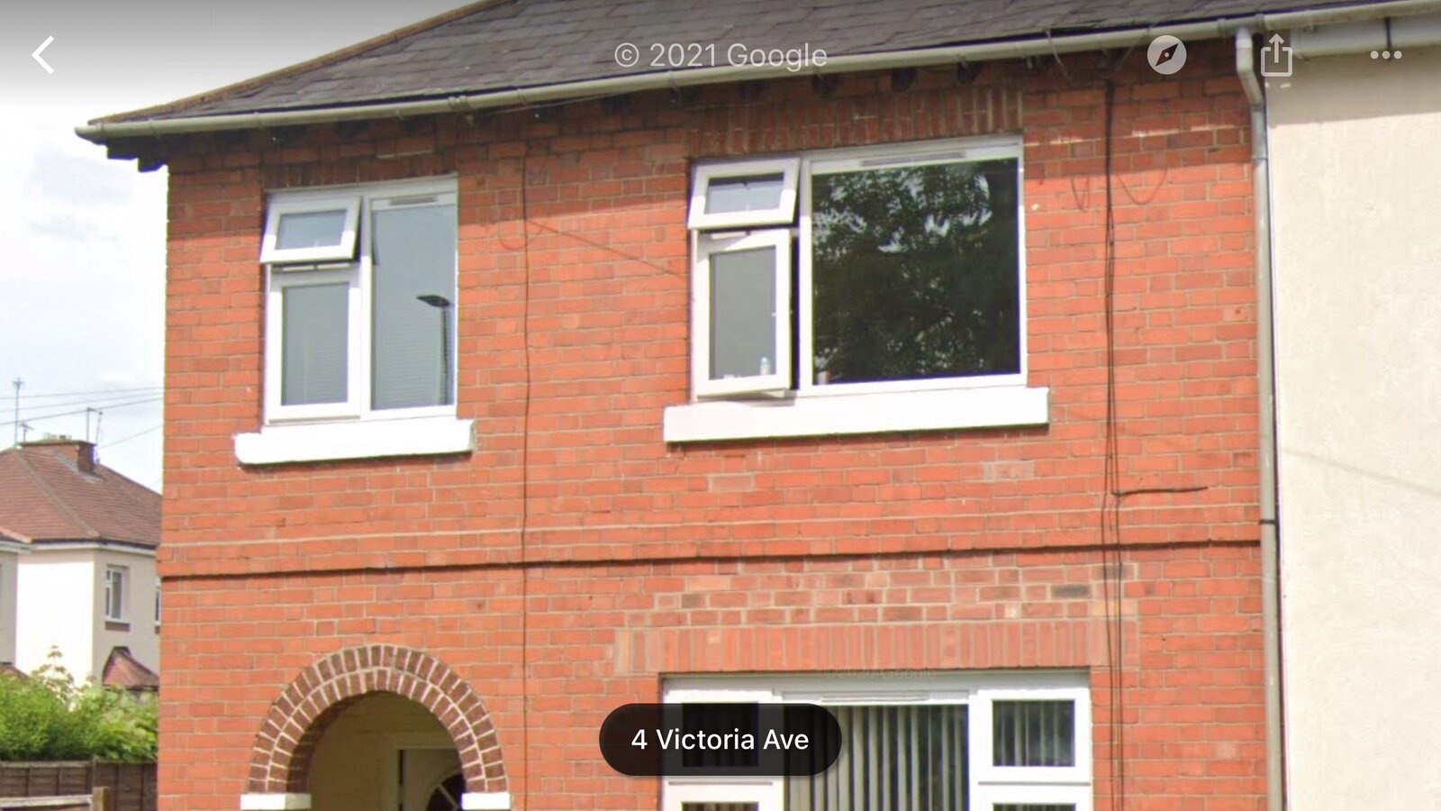

It's more related to the age of the property, past building standards and components wearing out, rather than ground monument.

I drove by today and noticed that the 5 properties opposite the house I'm looking to buy, have had some brickwork repairs done over the doors, but mainly windows.
I wanted to understand why that was, so I decided to ask here? and i attached 5 pictures.
Let me know your thoughts if you have any time. Thank you again
