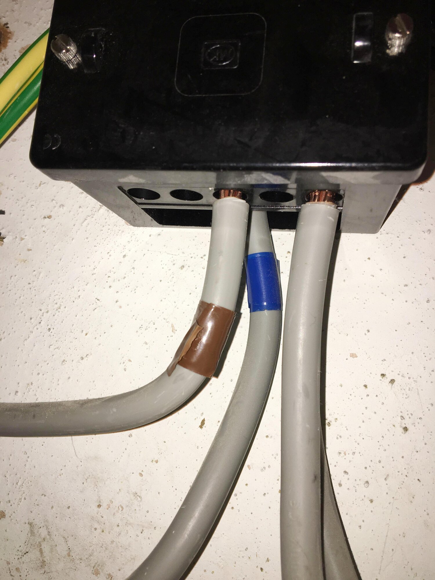

Just noticed this on my Henley block between my meter and my consumer unit. Tails on left are to consumer unit, tails on right are to electricity meter.
I am unsure if the tails have worked lose over time due to never being tightened up properly in the first place or this has always been like it and only just noticed.
Of course I no way to safely isolate and correct this without breaking the seal and pulling the main fuse, not that I am recommending or condoning this action and am well aware the cut out is the property of the DNO and one can not legally touch it without their permission.
The meter tails have a similar problem, although less exposed than my Henley block as shown below. What should I do?, as this look dangerous to me and I would personally rate a C1!
Regards: Elliott.
