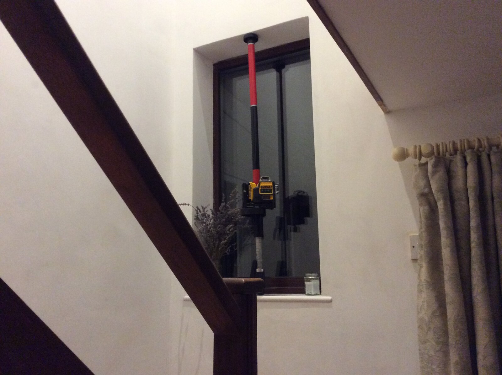

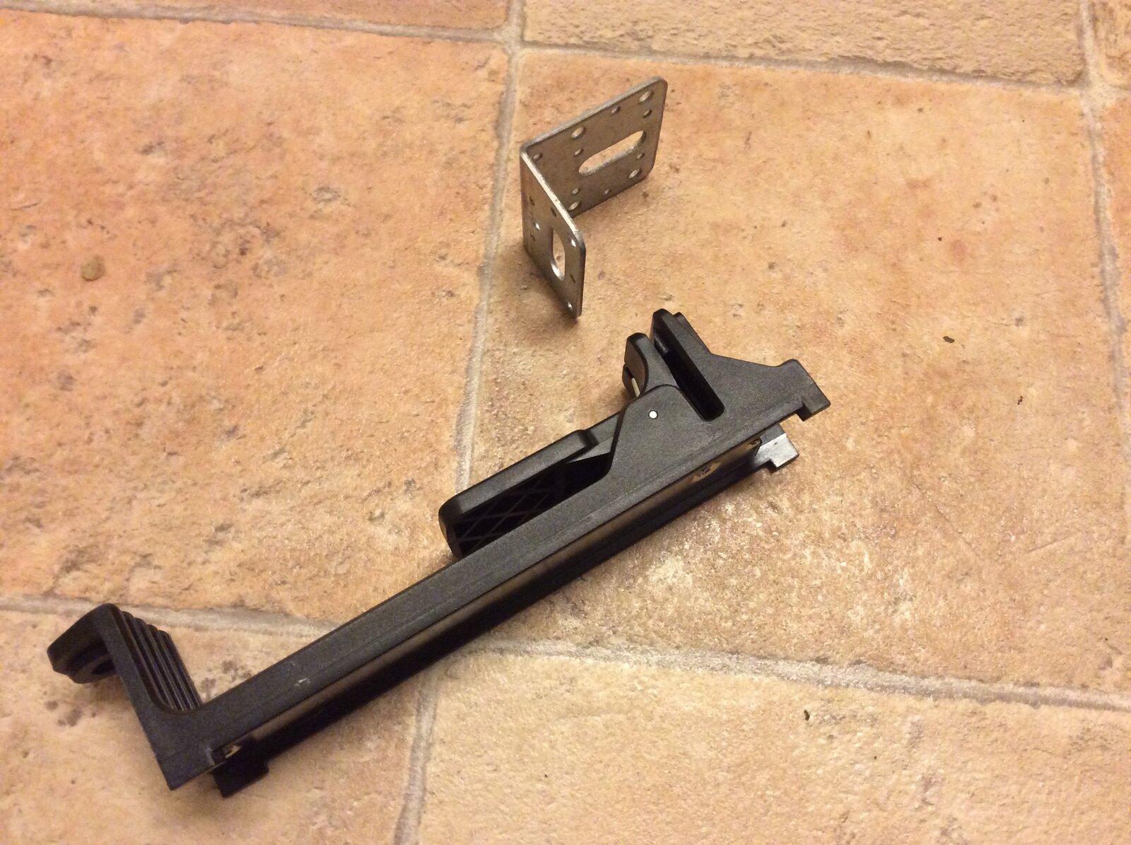

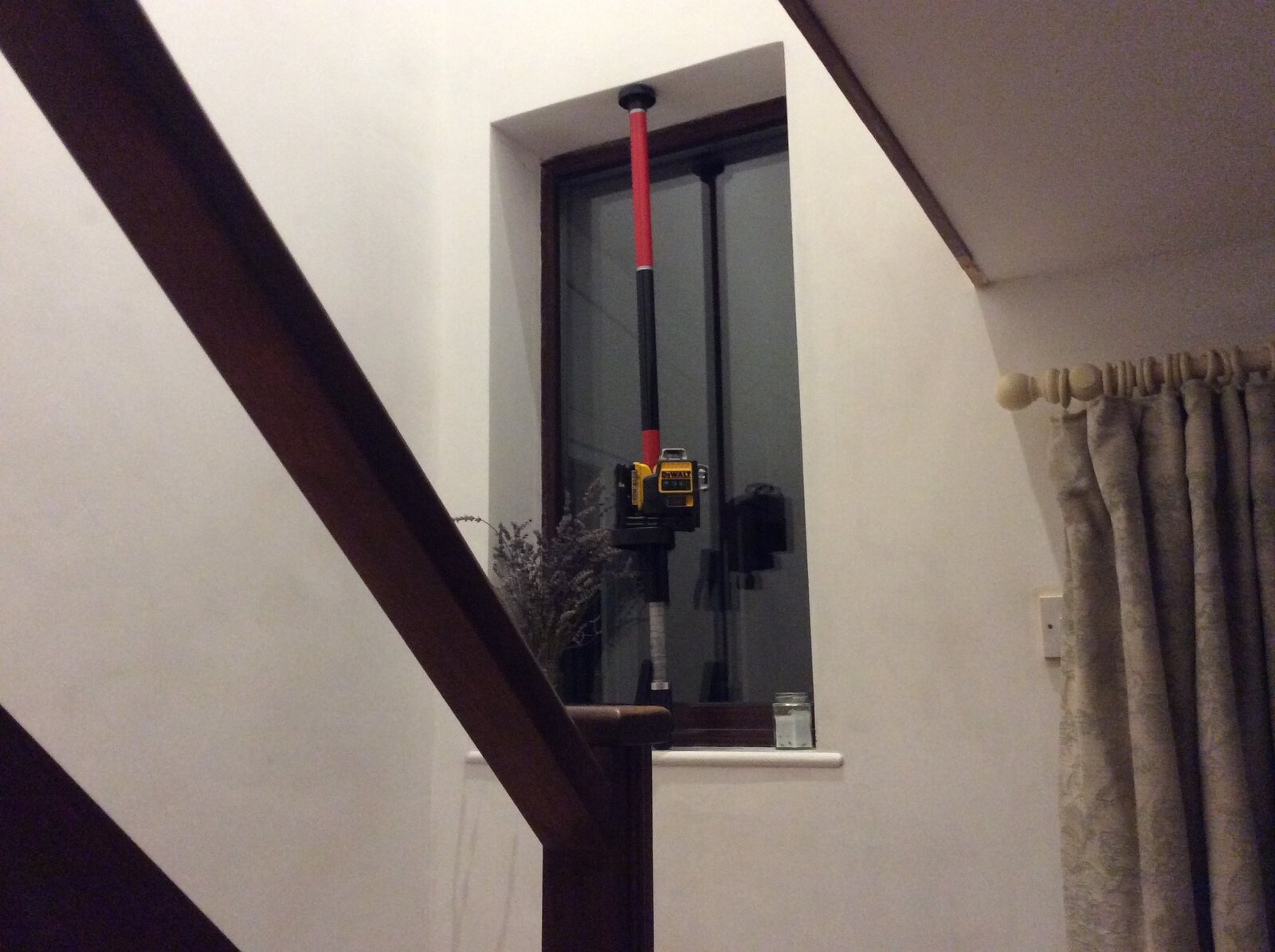

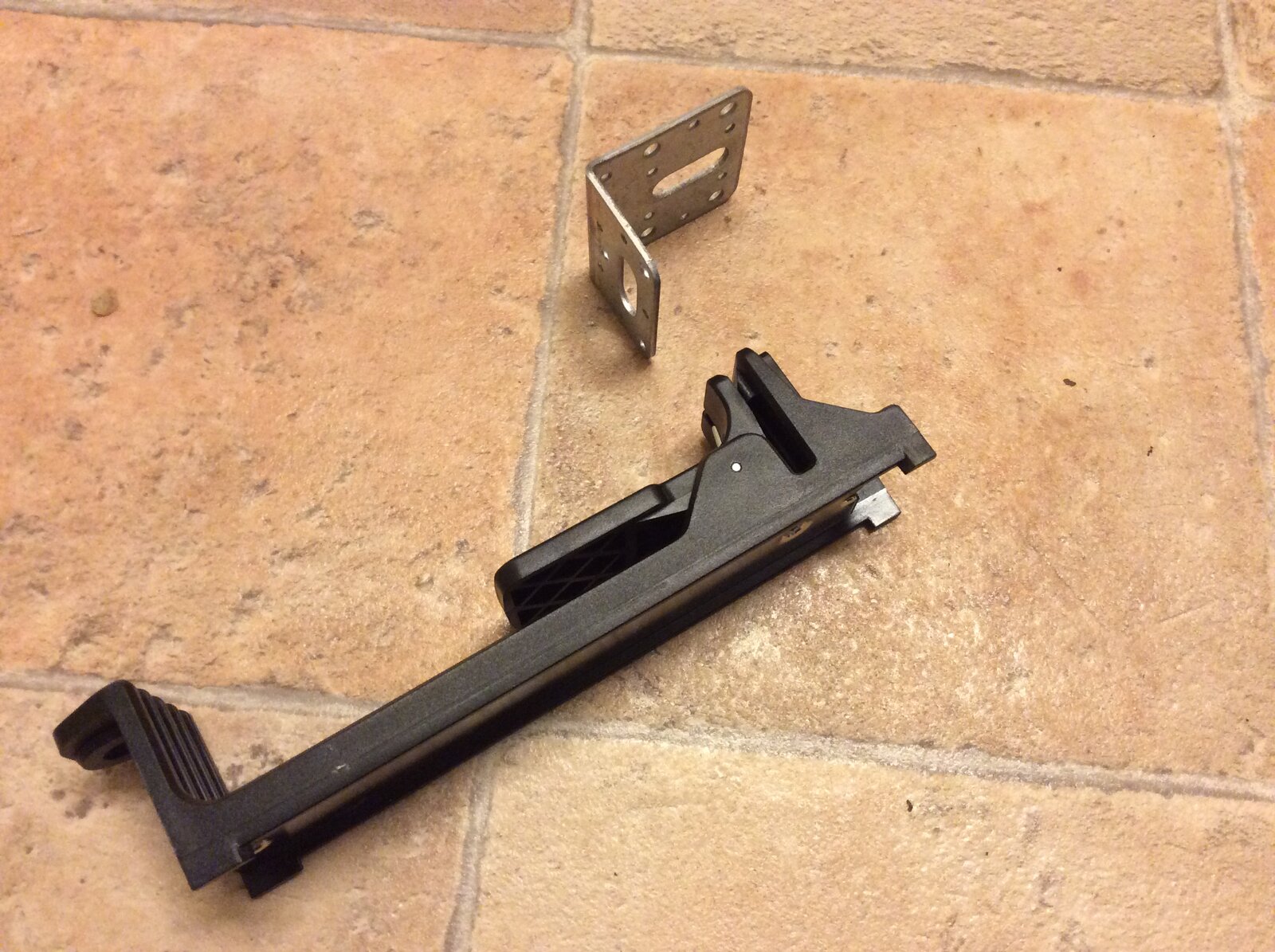

D426DBAF-1E34-43E8-852B-EB4DC26DBD24.jpeg 1DA7F35E-DC12-4EC8-BF95-B9B9589AC8E6.jpeg When I first got mine I used a combination of camera tripod, Strong angle bracket screwed to anywhere convenient , including lengths of timber wedged between floor and ceiling with wedge or winbag and the supplied clamp.
I now have proper tripod and sectional floor to ceiling pole which will break down to fit in window or door opening...the camera tripod was handy as the tilt platform could be used for inclines like stair hand rails

I find a pole will do more than a tripod inside....
