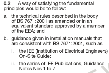

Maybe it was Approved Doc P, then. The original version contained this ...
... but that seems to be absent in the 2013 (in England) version.
Kind Regards, John
