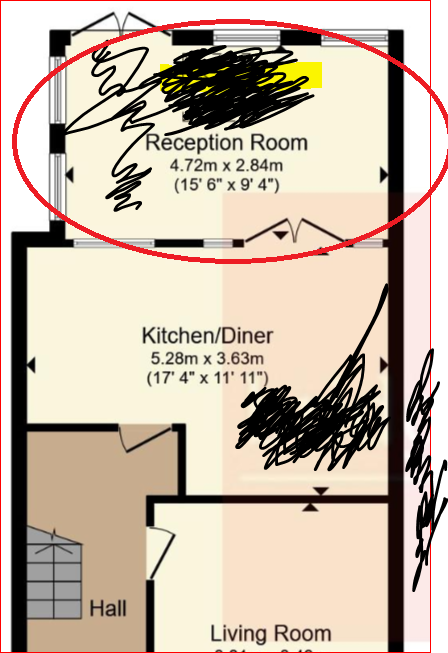

I asked my friend again today about the extension of the property he is trying to buy.
He said the seller is not using it as kitchen, it is used as a reception room. There is radiator, light etc.
Seller said, as it is considered as a porch, he does not need building regulation.
Please see the attached floor plan.
Pretty sure once a radiator has been added it's no longer a porch.
Someone who knows more can comment.
That may be true. The test is that the porch must be against the original house door, the door must be retained in position and any heating (the radiator) must not be connected to the main heating system. Also, the exemption does not apply to the electrical installation, which still requires a completion certificate, and the glazing must comply with glazing regulations.
Of course, the thing should still be built to a decent standard and your friend should satisfy himself of that.

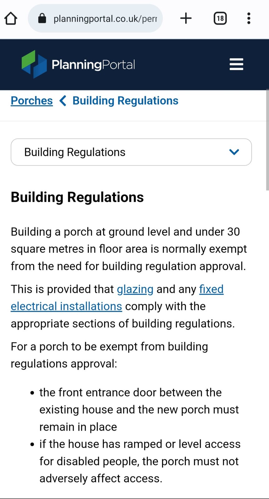

Apropos of nothing - planning portal now say 30sqm for a porch. Wasn't it 3? When did this change
But also a porch is at the front of the house not the rear? If anything that would be closer to being classed as a conservatory than a porch..
