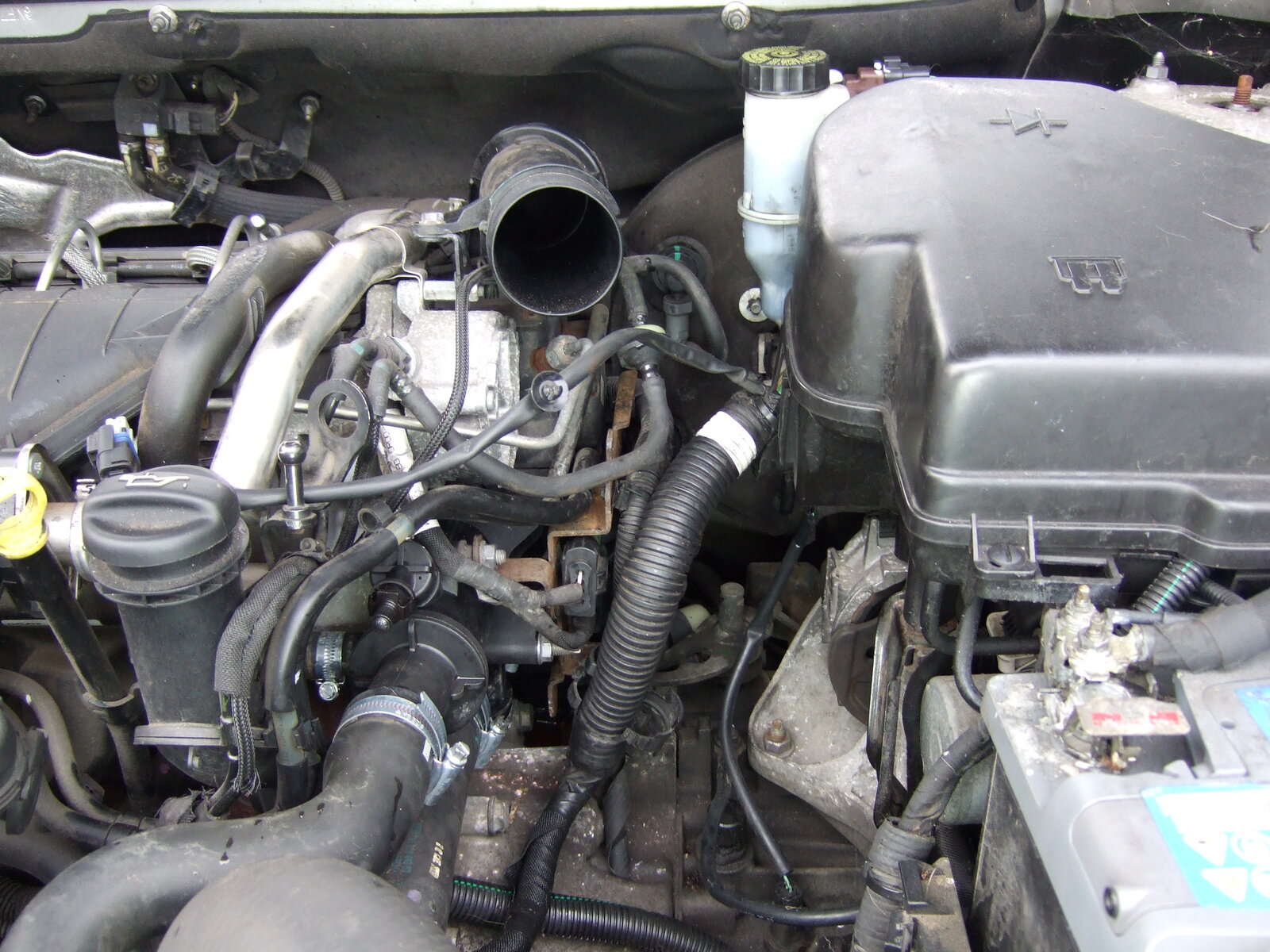

I love those sort of jobs John.:( Have you tried changing a thermostat in a late C5 2.0 diesel.(n)
Peter
I've done a 'how to' on the FCF forum. One chap got half way through doing it, put it back together and took it to his garage.:confused: The engine is pretty well built round it, gasket and housing was only about 25 pounds on ebay but it took me about 3 days to do it - not continuous. Had to buy a special tool to remove the rear hose. I would rather not do another one.
This was after I had partly put it back together - with jubilee clips!

Indeed they were.....
The idea these days is to get the whole engine up to an optimum temperature quickly and maintain that temperature (around 90 deg C) - this is to minimise pollution by reducing fuel consumption - that's why the thermostats now live at the bottom of the engine around where the bottom radiator hose enters the block.
So, the engine takes a wee while longer to warm up (minimised by thin radiators and small coolant volume) but once its up to temperature it tends to stay there.
In the old designs, the engine would heat up, the stat on the top of the motor would open and cool things down before the bottom end of the engine had a chance to heat up.
Access was great though!

Yep, about 10 minutes then. The old Citroen XM 2.1 diesel seems to have been the pilot for that, the thermostat was in the bottom hose at the back of the engine, but at least you could get at it, couldn't see it though, had to change it by feel. It was a very good engine for its time. Came out in '89 I think, ran up to about 2000, 12 valve, 110 bhp and very good on fuel.
