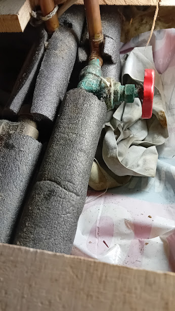

Guess what the EICR code in a rental property claims to be and what the £400 plus vodka repair "by December 7th to comply with the law" is.
Now I must point out there was absolutely no sign of water or damage to the CU or the cupboard containing it,
The tenant pointed to the repair to the ceiling due to a leak during lockdown, some 15ft away from the CU and not aware of any problem since, didn't have a clue why arrangements had been made for my visit.

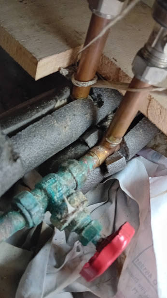

I was then taken to the bedroom above the ceiling repair where where we moved a dressing table and chest of drawers to allow us to move the double bed to reveal the pair of doors for an opening 2ft square to the triangular space they called the 'side loft' created by the chalet style roof, we removed boxes and suitcases, to reveal the 2 chrome isolating valves with absolutely no evidence of leaks.

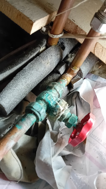

The bit of T&E is in intimate contact with the pipes, lifting the offcut of carpet and the loose floorboard (under instruction) revealed the 2 gate valves, one of which is very green but totally dry. It looks like is has been repaired with PTFE tape, the rag under it released dust into the air when I touched it so no sign of recent wetting.
Tenant said the space was open on the day the EICR was done and almost empty as they were getting Christmas Decs out, he looked in there but they were not aware he gained access to the valves. Nothing else to fit the description and above the CU cupboard is a bedroom with the radiator the other side of the room but again no evicence of leaking.

Well if it's any consolation, not being able to find anything relating to the report I was as confused as you. I did manage to reroute the T&E against the pipes while I was in there, which I would have accepted as a C3.
