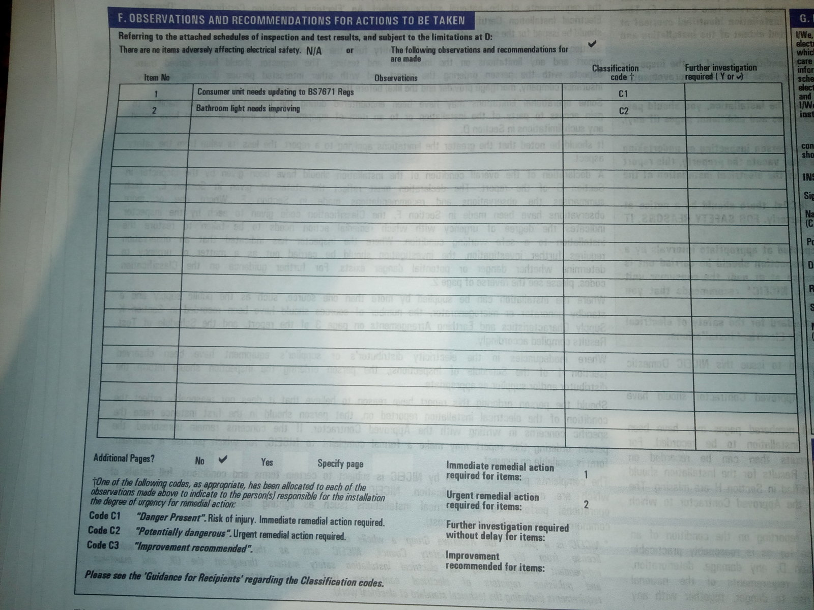

Hi, I have just had an EICR done on a basic 3 bed house with 6 circuits. It has come back with 2 issues and a quote for £600 for a new consumer unit (existing one is about 9 years old). I was told “some circuits don’t have an RCD so there could be a neutral to Earth fault so the electricity could come back out and electrocute me” and that it was urgent that this new consumer unit is fitted as my existing one isn't compliant.
Photos of a couple of pages of the EICR attached.
Hi, I have just had an EICR done on a basic 3 bed house with 6 circuits. It has come back with 2 issues and a quote for £600 for a new consumer unit (existing one is about 9 years old). I was told “some circuits don’t have an RCD so there could be a neutral to Earth fault so the electricity could come back out and electrocute me” and that it was urgent that this new consumer unit is fitted as my existing one isn't compliant. Photos of a couple of pages of the EICR attached.
For what it's worth, in my opinion it is seriously OTT to give a C1, and indicate that immediate replacement of the 9-year-old CU is required, because a cooker circuit and two lighting circuits are not RCD protected. If I were you, I would be looking for a different electrician, and seek his/her views about what (if any) remedial work is required
... and if "some circuits don’t have an RCD so there could be a neutral to Earth fault so the electricity could come back out and electrocute me” is remotely like what the electrician said to you, then that would strengthen my view that you need a different electrician!
Kind Regards, John
He's a crook, the regs are not retrospective and there appears to be nothing wrong with your cu.
The comment on your bathroom light is meaningless.
The test sheet is inaccurate , it says you don't have RCD's but lists RCD tripping currents of 30mA, which is a nonsense.
As above, you need a different electrician

Well, it's daft!
Point taken about not using him again, but it's annoying to pay for the same thing again.
There's probably no need to have another EICR done - it looks as if, in a 'factual' sense, the EICR was probably done reasonably well and conscientiously - the issue is about the interpretation of his observations and results, and his 'recommendations'. I would suggest that you show the EICR to another electrician and see what he/she feels about any remedial work that might be required.

As far as I can see, it only states the 30mA RCD tripping current for those three circuits which are RCD protected. What is less clear is why he has apparently not tested the trip time of that RCD.

There's no provision on the form for recording details of the RCD (only provision the BS No. of the "Overcurrent Protection Device" - which obviously doesn't include RCDs), and the only way of indicating that a circuit is RCD protected is to insert the appropriate figure (i.e. 30mA) in the "RCD IΔn" column for the circuits in question - which is precisely what he has done for the three (RCD-protected) used circuits 'below' the RCD in the Schedule.
Why do you think that there is no entry in the "RCD IΔn" column for the three (NOT RCD-protected) used circuits 'above' the RCD in the Schedule?
