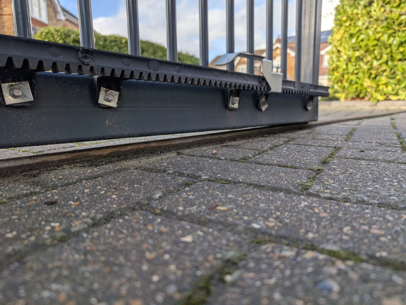

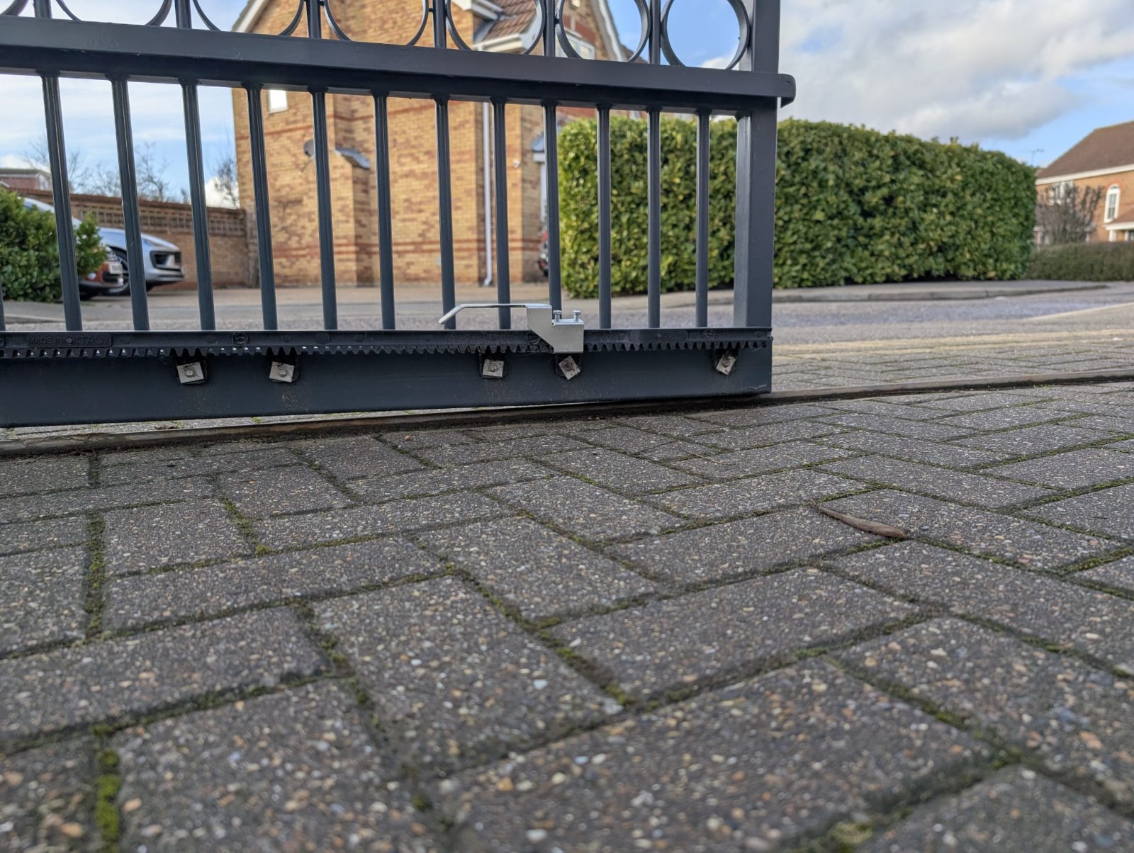

Afternoon all, our gate is now catching the track very slightly sometimes its goes over the track other days its stuck and wont open and close, a light push and it will work. I used some steel epoxy last week and just very thinly put it on the area where the wheel was when the bottom caught the track and it worked, it only lasted a few days and catching again as the epoxy didn't last despite saying its as good as steel. any suggestions on what i can do to get the gate opening and closing on its own for now. when it warms up i will need to get someone to adjust it or start again. I was ripped off with it, guy installed it and its never been right after a few weeks of installing company gone bust.
I was thinking maybe some different epoxy, or maybe a 1or 2mm thin steel piece of sheet bent round the track just enough that the wheel lifts over it and raises the edge of the gate, its only in one spot for about 3inches then moves along fine

I can, its catching the track just at the front edge of the gate as it goes up and down the driveway so i was assuming it might be the track has moved or ground has moved. i have a manual for the DEA motor but didn't think there would be much adjustment on it to move the gate up or down

Looks to me as though the driveway has sunk slightly at one point, causing the track to sink likewise. Can you prise the track up slightly and insert some packing below it at the critical point?

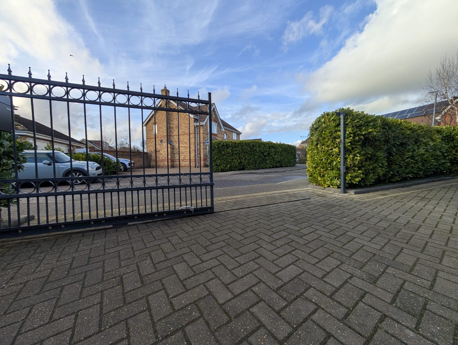

I can see your issue! The track has been laid with the road and not level. This is what is likely causing the issue.
With tracked sliding gates the track needs to be laid level for multiple reasons. 1 being if you remove the motor, or it fails the gate will just roll freely down hill and potentially hit something/someone.
2. You are putting extra strain on the motor and will run down it’s life expectancy a lot quicker
3. ⁠you get issues like this where it snags and catches along the way.
It’s not un fixable but it is likely to be a job of removing the track, laying a new level track and then re install the gate. I can certainly quote you for this?

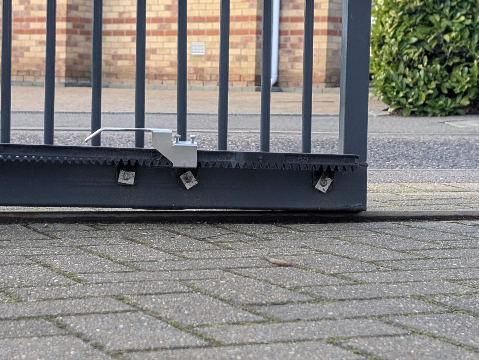

i was hoping that something temp on the track top could lift it just slightly
Isn't the wheel then likely to come off the track?
Can you adjust the wheel mounting so that the bottom of the gate is a tad higher above the track?

it needs about 1mm to clear the track, ive tested it with the epoxy resin putty and moved up and down fine, the wheel goes around the track alittle aswell so i not lifting it very high to come off the track the wheel has no adjustment to it that i can see

It looks to me as though it is pivoting on the runner and that the oposite end of the gate ( to where it is catching ) needs to be lowered slightly. I would have thought dropping it just 1 or 2 mm over that length would raise the lead edge that is catching. Diifficult to tell if that is feasible without pics of the other end of the gate and motor

It needs way more than 1mm. Gap between gate and track should be the same across the whole width of the gate in all positions between fully open and fully closed.
Either that gate is distorted or the track is not level.
the track is running down the driveway from right to left
The gate company information is correct - there is only one solution which is to remove the track and reinstall it properly.
Sliding gates MUST be level, they will never operate correctly on a slope.

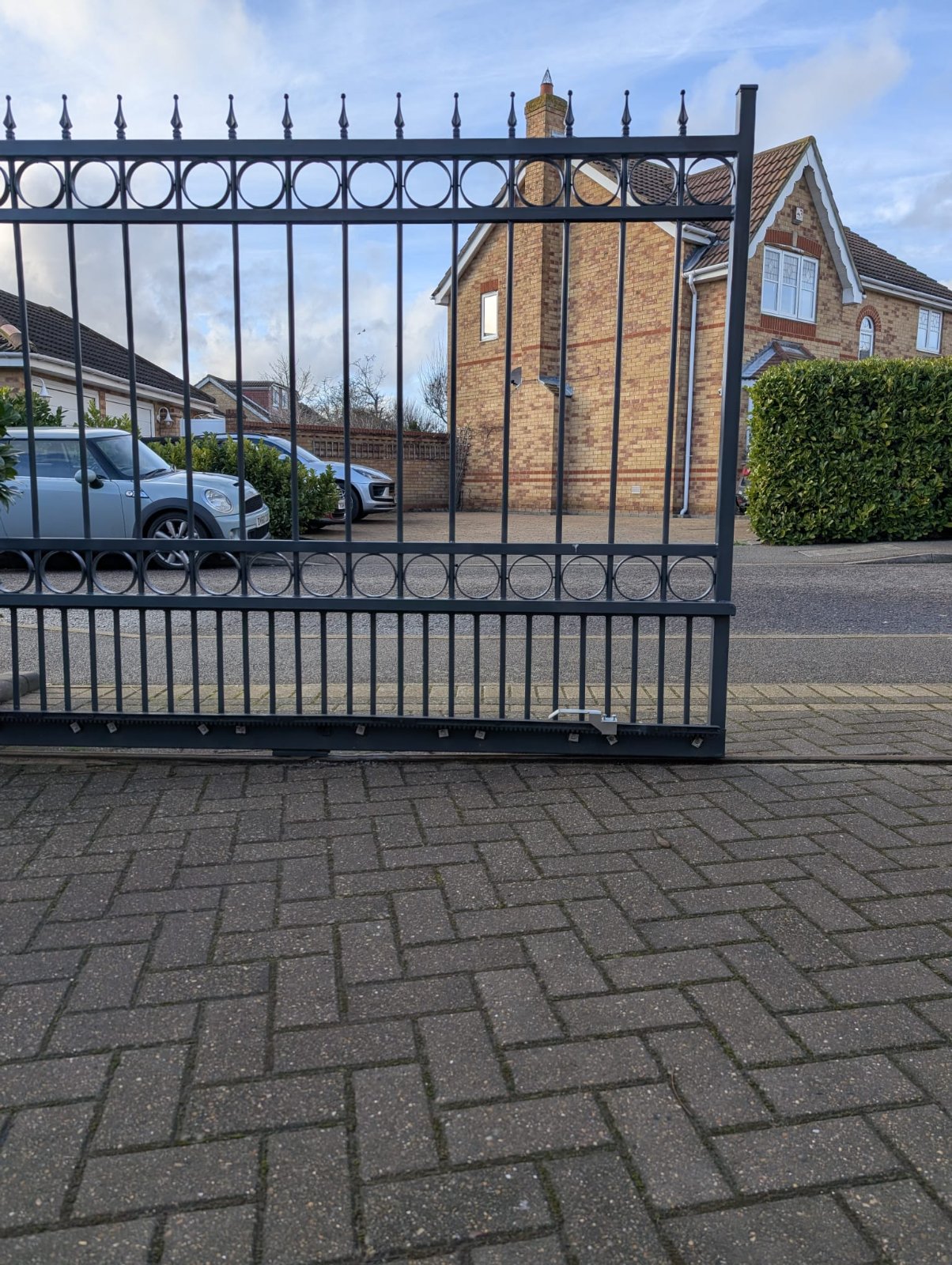

There doesn't appear to be any sensors at the end of the gate that is visible or on the end post, so you will need to get the gate company to install the required safety devices as well.

thanks, there are some sensors that stop the gate on each end post about 2ft off the ground. Ive got a gate company coming round tomorrow to take a look. I had another company round today and they said that they could lift the gate up, take the wheels off and either put packers under the mountings and reweld them on so that they sit alittle higher, he also said the tank motor housing should have some bolts which could move the motor up slightly. I'll see what the company tomorrow suggests, but initially he was saying it all has to be dug out and re done which i think is going to be more expensive. worst case for now i just manually close it night, it does slide up and down without much pushing.
Those are only of use for detecting large items such as vehicles constructing the gate. The absolute bare minimum.
Sliding gates need sensors that cover the full height of the gate and posts at both ends, so that they don't crush objects/animals/people that are in the way, including where people put their arms through the bars of the gate or between the gate and the post.
