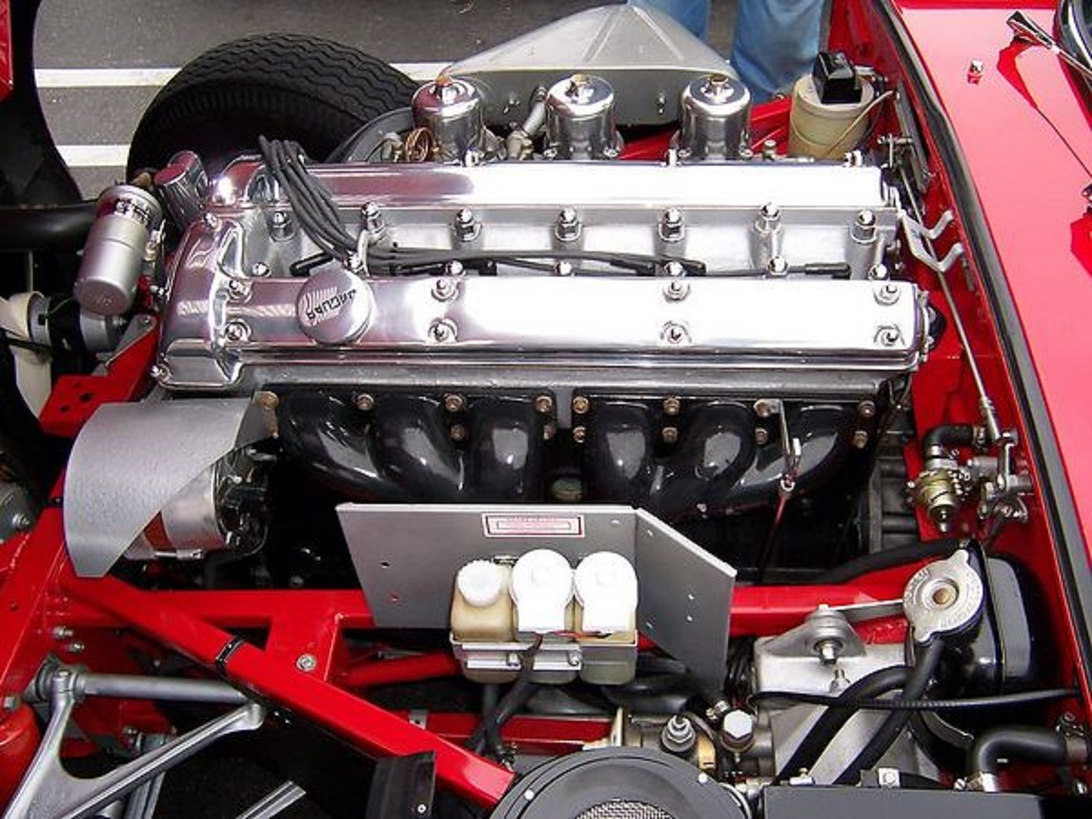

Almost the oldest car I ever had was an Alfa Romeo DOHC and it worked fine on 20/50. The Alfa engine did have big "bucket" tappets and very big, lightly-loaded cams, and was a lot more advanced than mainstream British engines of the time. I don't know when it was introduced, but no later than the cars you mention.

the comparable Jag XK6 engine was a little earlier
That looks like a V8, John. Are you sure you did not intend to show this?

Nope.
Cross flow DOHC straight four
Count the plugs on this bigger pic

On mine I picked out the lettering at the front of the cover in red paint
Note the trouble they went to with the sexy CH nuts.
Mine was just the family saloon. 5 speed box unusual for the age. Nice rear axle. Useless handbrake.

Nope.
I must have seen the cam-covers as two cylinder heads. :confused: The bigger image helps, thanks...along with my reading specs. :)
Good pic, though. Are those chrome CH nuts called acorns? Also what is the purpose of the female nuts between the plugs?
yes, very ornamental. You can also get dome nuts which are not quite so pretty (and do not have extra space in case the stud should be a bit on the long side).
The big-looking nuts on the cam covers are just sleeve nuts with decoratively huge heads. You can take them off with your fingers.
The spark plugs are in deep wells to make it easier for oil, dirt and small parts to fall down the holes. The valves are large, and their stems are hollow and filled with sodium, claimed to take the heat away better.
