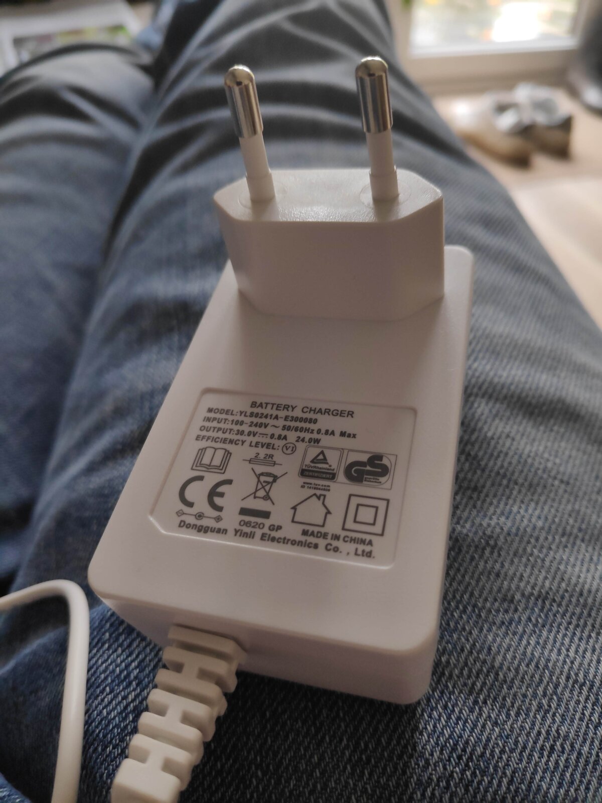

I have recently purchased a hoover which came with an EU plug and UK adapter. Unfortunately a UK charging cable is not available. The hoover has a charging bracket which is wall mounted. I'm trying to work out the best way to mount and connect it to the supply. I really don't want to have a socket, adapter & charger all sticking out.
Can anyone suggest an alternative way to supply power to the mount? Hopefully that makes sense.

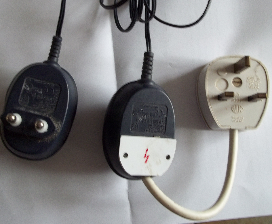

I assume the charger is built into the EU "plug" and thus the EU "plug" cannot be cut off the lead and replaced by a normal UK plug.
This was my ( dubious ) solution to a similar problem.
This is the charger
