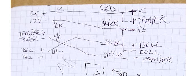

Ta-Da, I moved a bell box at work, 25.6.98.
I have no idea on make of alarm or bellbox but from this I'll guess in the panel 'tamper +' = '12V+' and 'Bell-' = '12V-'

My alarm experience is fairly limited to mostly personal sytems: late 70s in family home, Sisters home, my first house ~1984, helped a friend with 4 or 5 systems mid 80's and a few odd changes since, usually a move of an item - such as the 2 shown or replace faulty parts. Additionally I had a small selection of parts which I'd put in temporary adhoc systems such as exhibitions, recently disposed of while having a bit of a sortout. Let's say about 20 -30 systems in all.
My recollection of the early systems which may be 'misty' is 3 pairs to the bell box; power, bell, tamper. Both of those notes appear to back that up but there is no way I can remember if any other terminals went unused or if the 'titles' I noted are an interpretation.

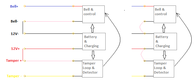

However redrawing to this:
If the +ve & -ve terminals in the panel are linked as shown (And I have no idea if this is the case) then the alternative arrangement on the right looks to be in order and Securespark seems to be aware of a 3rd party doing something similar.
I will happily say I'm not an expert on this and it's a while since I've had any dealings, very possibly that 2011.
Some have a strobe connection +ve and -ve but some only need one connection as the supply (usually +ve) is shared.
Of course you could still have a strobe wired across the "Bell" terminals but would only follow the bell signal if activated rather than follow say internal sounder output or "Set Confirmation" etc.
