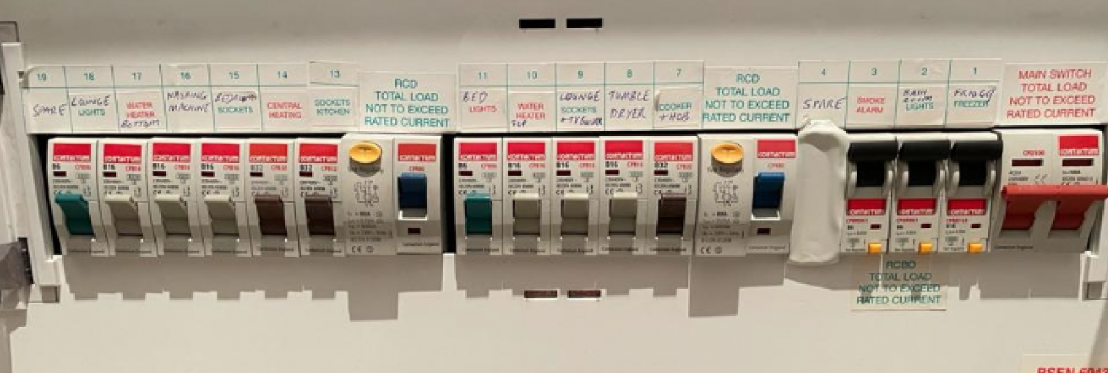

Failed EICR-is is justifiable to change RCD box(fuse box)

My DIYer background suggests that there should also be two 'real' blanking plates added to that CU to stop fingers touching internal live wires.
Presume two of these should have also been added in the 'spare' slots:

The EICR is not a fixed pass or fail like a car MOT, it is down to the inspector as to if he feels it is dangerous (C1) or potentially dangerous (C2) and stick tape over the unused slot for me would be a fail, would not expect any electrician to pass that.
However as it if when fitted a RCD must work not so cut and dried. Personally I think all installations today should be RCD protected, and BS7671 talks about design, and it was clearly designed to have RCD protection on all circuits. And it says "Bed Lights" so seems likely that also supplies the bathroom and also likely bathroom needs RCD protection.
I can't see why any Landlord would want to get out of renewing the RCD?
I will admit I was rather surprised reading BBC web pages that it is so hard to evict a tenant. It does seem the Landlord has a raw deal.
13 Mar 2010
620
16
London
Unfortunately I don't think your installation has had an EICR. Just a passing glance.
Did he have access to the Electrical installation certificate for the board. Wondering where he got the numbers from. If he didn't then it is a pure work of fiction.
The schedule of inspections shows errors, eg. its ticking satisfactory for a surge device which does not exist, and that the IP rating of the CU is satisfactory, when there is a great big hole in it.
That RCD is about £25.00 plus about £80 to swap it out. What were the numbers for the failed RCD?
The EICR should take all day for that amount of circuits, and would be closer to £300.

Having read this thread with interest, and looked at the OP's EICR - isn't the PFC figure at the top of the second page also wrong ? I make the PFC 1.44KA for a Ze of 0.16 on 230V supply (230/0.16 = 1437). or am i missing something?
7 Jul 2010
38,285
4,630
Retired to:
Portugal
You are probably correct but who knows which is the wrong figure?
The PFC is the greater of PSCC and PEFC so it could be correct but as the installation is recorded as TN-C-S this is unlikely.
Perhaps it is actually still TN-S but we are advised to treat such installation as TN-C-S.
28 Jan 2011
50,132
3,353
Buckinghamshire
Your calculation is obviously correct. I suppose that, since those figures are "by enquiry or by measurement", it's just possible that the 2.5 kA figure was obtained 'by enquiry', but that's a bit far-fetched and probably unnecessarily 'generous' to the perpetrator!
In an attempt to ascertain what the Ze action was, I've looked at the recorded R1+R2 and Zs figures, but the Ze implied by those is somewhat 'all over the place' (see below). A few are appreciably greater than 0.16Ω, whilst most are below 0.16Ω, some extremely low. The lowest (0.02Ω) would translate to a PFC at origin of 11.5 kA. ... so goodness knows what the Ze actually is.
In passing, regarding circuits 12 & 13, is it really very likely that the 'Central Heating' circuit is a 32A ring, whereas the 'Bedroom Sockets' circuit is a 16A radial?
Since there is just one PEN at the origin of a TN-C-S installation, the PEFC and PSCC at the origin surely must be the same thing, mustn't they?

It surely would not make sense to 'treat an installation as TN-C-S' if visual inspection clearly indicated that there was no G/Y connecting the cutout to the MET, would it?
Ok. Strictly speaking I should have said:
"Perhaps it is actually still TN-S but we are advised to treat such installation as PME."
As there is no option on the certificate for PME perhaps it has been recorded as TN-C-S and it is this that is the error.
On the other hand, if inspection indicated that there was a connection between cutout and MET, then if there were also an (effective) TN-S connection to the MET ('in parallel' with the TN-C-S 'earth') then that would, indeed, result in the us usual situation of PEFC being greater than PSCC - but, again, that situation should be apparent on visual inspection.
Well, all sorts of things could be.
I was merely pointing out that out of Ze 0.16, PFC 2.5 and TN-C-S, Licklieder was only considering that the PFC 2.5 might be the mistake.
28 Jan 2011
50,132
3,353
Buckinghamshire
I still don't really understand.
A DNO-supplied 'earth' has to be either TN-S or TN-C-S, and that's all the installation 'knows' (or cares) about. 'PME' is something that DNOs do (have to do, at least in UK) to make TN-C-S a little 'safer' - but, again, an installation knows nothing about that. I suppose they could also 'PME' TN-S supplies if they wanted to, but I'm not aware of their doing that.
The existence of the PME obviously means that the "N" component of "Ze" (or of an L-N loop path) will be at least a little lower than the "L" component, since the PME provides some 'parallel paths" for the N. However, again, an installation doesn't 'know' about that. In particular, it doesn't alter the fact that (with TN-C-S) PEFC and PSCC will be the same, since the ('PME') paths in parallel with the N supply conductor are part of the fault path in either case.
Fair enough. In any event, we don't know where the 0.16Ω Ze 'came from', and the figures I posted above indicate that the recorded R1+R2 and corresponding Zs figures do nothing to support any particular value of Ze - as I showed, the figures for one of the circuits suggest a Ze of 0.02Ω, which would lead to a PFC at origin of 11.5 kA !
