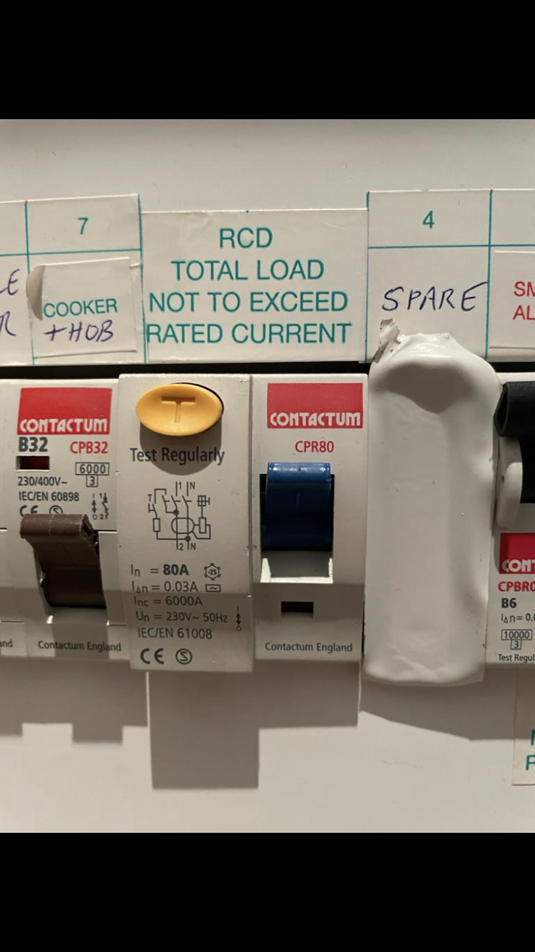

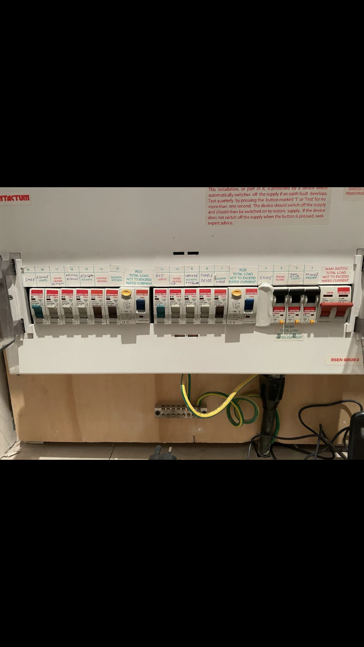

    Photo of the “fuse board” please!
    • Like Like x 1

    The RCD box is £150.00 and a work of £30.00. He mentioned no rewiring needed
  8. Iri
    Iri
    Joined:
    31 May 2021
    Messages:
    7
    Thanks Received:
    Country:
    I have asked my tenant to make a picture of it! he will do it when he is back home.

    This is a typical RCD of the type that's been suggested as needing replacement:
    Not the whole fusebox / consumer unit.
    13 circuits and 40 minutes is 3 minutes per circuit, assuming 100% of the time was spent actually testing and inspecting.
    Clearly that is impossible.

    The price to buy one of those is approx £40.

    So he tested 3 RCBO's
    And 2 RCDs - 1 of which failed
    He's only going to charge £30 labour to replace and produce the necessary PASS paperwork.
    So its swings and round-abouts.
    Overall it seams you have a good CU layout. And overall cost of EICR and repair isn't bad

    It is what it is, but I wonder why the spark fitted 13 circuits in a 1 bed flat?
