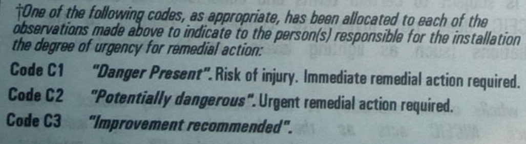

https://imgur.com/a/9OERsDo
Part of the report

It might be.
If you are a landlord, and you are having this done so you can let the property, then most, if not all, responsible landlords would say that be it a C2 or a C3, to let a property without RCD protection is not the done thing. Or indeed to risk any possible hassles by letting it with any codes present. If the electrician knows the situation then the best advice could easily have been that there's no point. Although you would have thought he'd have explained himself.
Other than that, it is not correct to say that, generically, there is no point to having an EICR done if there's no RCD, nor is it true to say that you have to have the CU updated. My advice is that you should, but that's for safety reasons, not regulatory compliance.
Be it C2 or C3, it will get coded, as it is a non-compliance with the current Wiring Regulations
No way should it be a C1, and quite honestly I'd argue against C2. Yes, it is potentially dangerous, but it is wrong to say that urgent remedial action is required.
"Advisable", yes, even "strongly advisable". But not "required".

"Main fuse not labelled" does not make sense
That's down as a limitation rather than a code, so presumably he wrote that as he couldn't confirm that the fuse is suitable for the tails. I think that would be the case for a lot of properties, in ours even when the DNO guy came to replace the head, he had no idea what rating the old fuse was. The new fuse carrier was stickered on the outside of the case.
