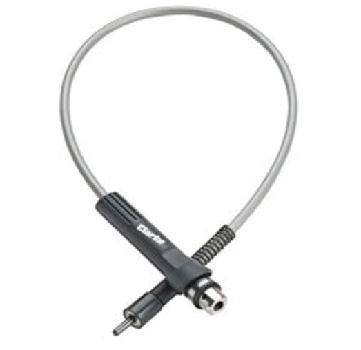

What about a flexible shaft, of which umpteen types are readily available - like ...
Kind Regards, John
Excellent, thanks. I think both of those solutions would work.
