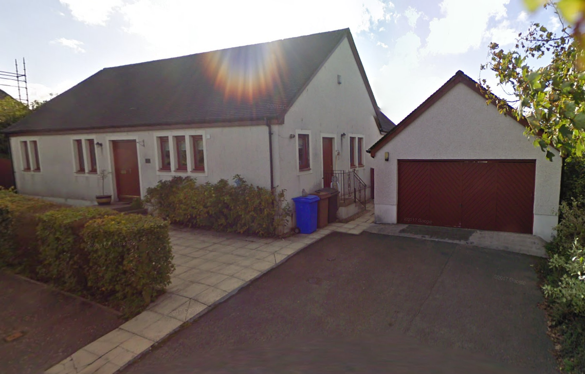

Here's one. Smooth render base course to ground level. The garage is the same and has 100mm block work walls with piers, therefore easy to see internally and no damp.
If you were the manager then why did you first claim you had seen loads of them as though you were a passing spectator?
Why have you avoided my questions? Evasions are not technical answers. Is that how you managed your site?
After first claiming that it was done to the latest Blg Regs and NHBC you now claim it was actually a requirement of the local authority - but only for homes "built in the country" apparently?
"All still standing" - as a construction manager do you typically expect rising damp to collapse buildings?
Do you expect anyone with trade experience to believe you when you claim this local authority has bypassed basic science, 100yrs of experience and common building sense, & forced you to build bad?
I really don't care what you or anyone else believes. What about the picture of the real world example I posted above? Or I am just making all this up?

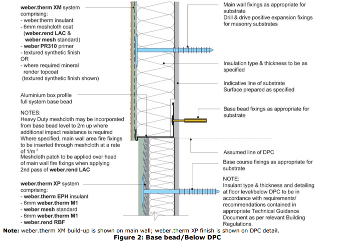

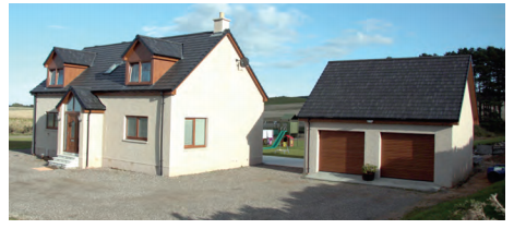

Here is another example of smooth render to ground level taken from a Local Authorities "guidance on housing in the countryside". The first one I looked at but I suspect most are the same, my LA is.
well thats flat out wrong.
I've shown you real world examples where it is done, and the first one has Building Control sign off and an NHBC warranty.
I've shown you a technical document showing below DPC fitting of an EWI system.
How about you provide evidence or guidance proving your position rather than relying on this...
